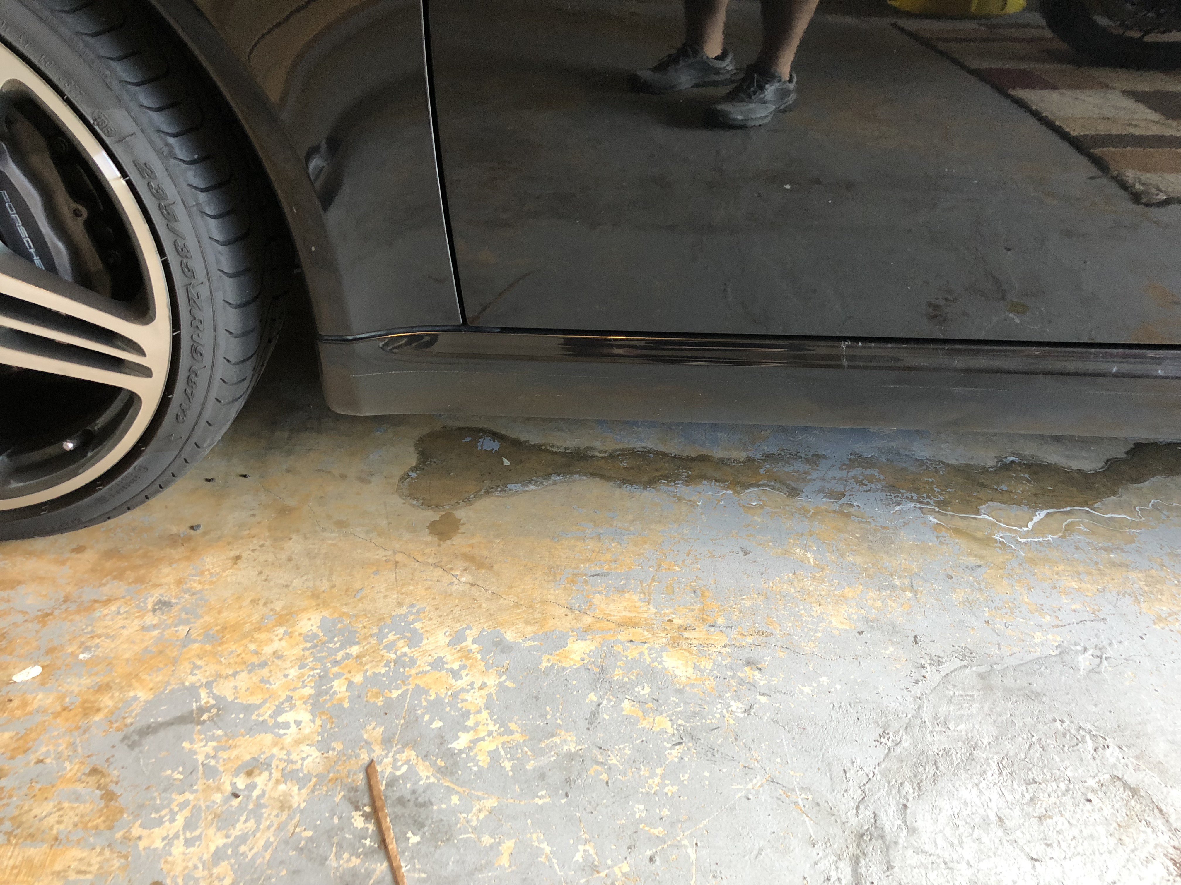

I noticed some water on the back of my 911 (2005 997 Carrera) this afternoon. Looking under the car, found it was coming from the front, behind the driver-side tire. Looks like the windshield washer tank is leaking? Considering the car's age and that I've never had to replace it before, I assume that's it. Anyone know how hard to replace the tank is?

I had mine done at the shop. The tank was cracked due to the plastic becoming brittle after 13 years.  I didn’t have the confidence to do it my self. I had the front suspension done at the same time as it was about knackered

In my experience the most common failure is at the washer pump. Easy replacement DIY. Buy your new one from Amazon or Pelican for $10 to $20 - most German cars use the same pump so there's many manufacturers out there - I bought a Continental one as I believe they are the OEM manufacturer.

Yes, mine has the pump leaking not the rubber gasket. Still replacing the pump is either 80$ (OE) or 25$ OEM. Not a difficult task to do (in my opinion) if you’re handy.
