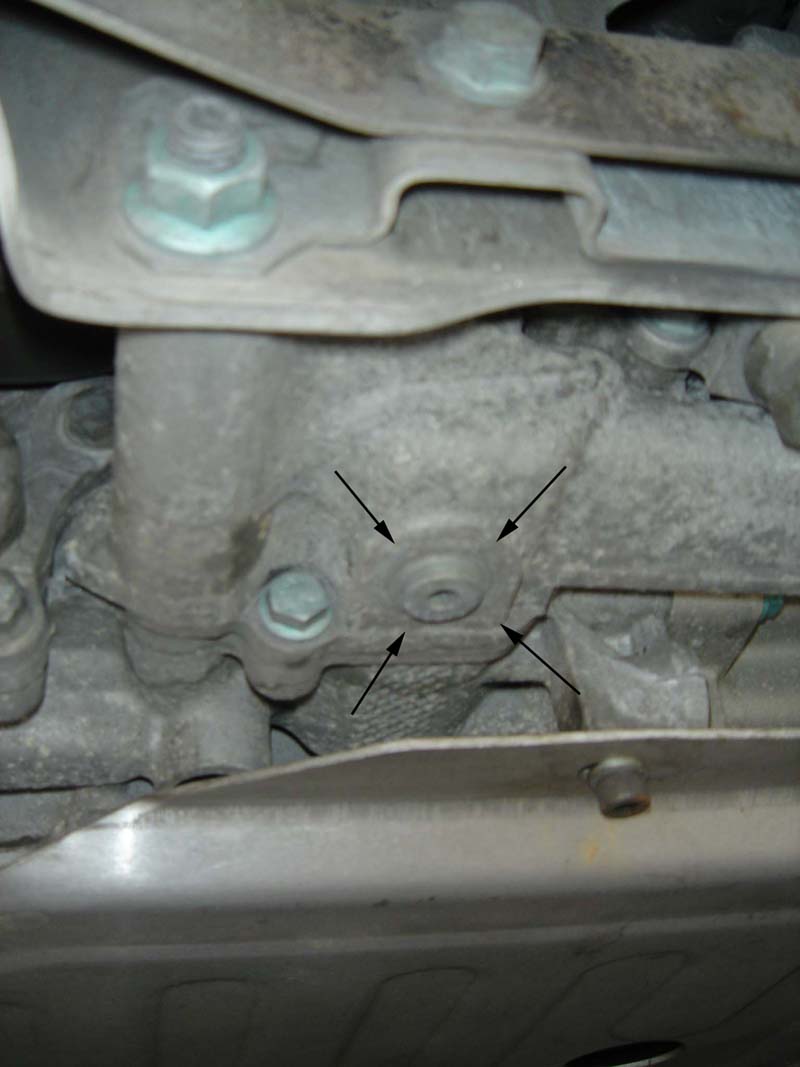

MY996. here are the pics. You can see the allen wrench inserted in the plug. And YES, the coolant SHOULD be changed every 2 - 3 years regardless of what Porsche says. It breaks down and gets dirty just like your oil. It will also help prevent hard mineral buildup and blockage that would require more costly repairs in the future. It is a great investment of 1 hour time and $20.

1999 - Thanks for your response. In case I need to change the fluid, please see the attached picture.
Are the arrows pointing to the coolant drain screw? If so, what size hex key do you have inserted in the screw. Thanks everyone for your help and suggestions.

... I use a 3/16 inch allen wrench.
All German cars use fittings and fasteners that are metric. Use the correct metric size or you risk rounding out. For drain plugs like this, I use a hex key that fits my rachet so you can get good pressure on the plug and turn it cleanly.

I realize the bolts are metric but this plug is only lightly torqued and a 3/16 works fine. The correct metric wrench would also work.
