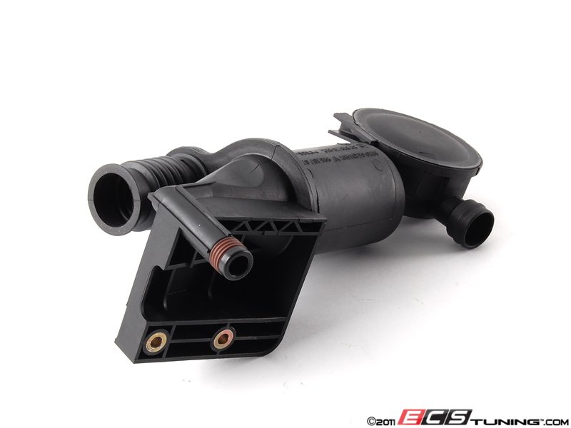

On your vehicle, there are two hoses on the AOS, one running to the PCV valve on the engine, the other back into the engine case, plus the arm that allows the oil to drain back into the engine, plus a third vacuum line:

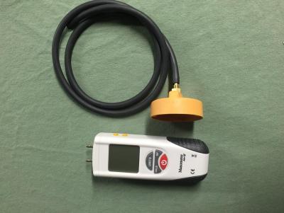

Some simple rules on the AOS: Only use factory parts; the aftermarket units are terrible, often failing right out of the box.  The AOS is a consumable, it needs to be monitored and replaced when necessary.  Porsche shops typically use a digital manometer (around $40 online) connected to an old oil fill cap to test the AOS; when the vacuum on a fully warmed up engine exceeds 5 inches of vacuum, it is time to replace it.
