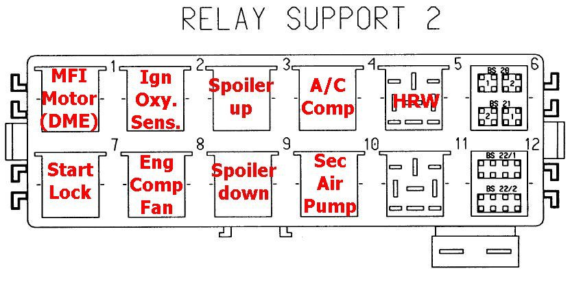

There is also an AC compressor relay in Relay Support 2.  Might think about replacing that relay to eliminate a potential problem.
Share this post

Joe, where is this relay (s)?  What you're suggesting is replacing No. 4, A/C Compressor?  Again thanks for the help...
Share this post
Thanks Loren,
I was afraid of that, I have a back seat delete so it's a little work getting the hinged package tray out of it's resting place...
