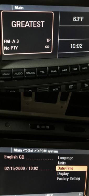

Out of curiosity do you have a date displayed on the Main PCM screen or is it missing? Mine still says 01/09/2000 and is not on the Main screen any longer.

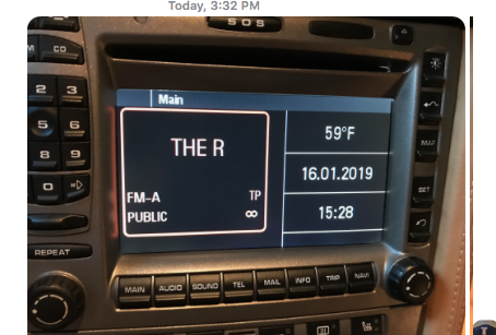

This is what I have:

so the local Porsche of new orleans dealer was nice to offer to look at the car for the date not showing issue.  They hooked it up to the computer but could not get the date to stick.  The tech was using the latest version.  He checked a couple of things and all looked good but when he tried to set the date it would not stick.  I was there and saw that the date was still blank.  It would take for a sec, then blank out.  He offered to unpack an older version diagnostic and said he would try on sat if I went back.  I said okay.  For the heck of it, on the way back home I decided to change (again) the date format just to see.  The date was still not showing on the main display.  get home, turn car off.  Come in to look online for the latest map disc info - mine's 2013 and the tech mentioned that it may be the latest, so I check online and go back out to the car to get my software version as parts says "Special Note: The new navigation DVD(s) can only be used with software version "B" in PCM 2.1. If "A" software is present, your local dealer may need to update the PCM software (effects 2005-06 cars only)."
Soooo, when I turn on the car, this is what I see:
The date is back.  Guess ill see if it sticks and report back.

My date is incorrect and does not display on the main PCM display now. The time and timezone are correct at least. I've tried different date formats too. If I have time I may run down to my local indy that has PIWIS and see if that helps the issue. Its a small annoyance.
