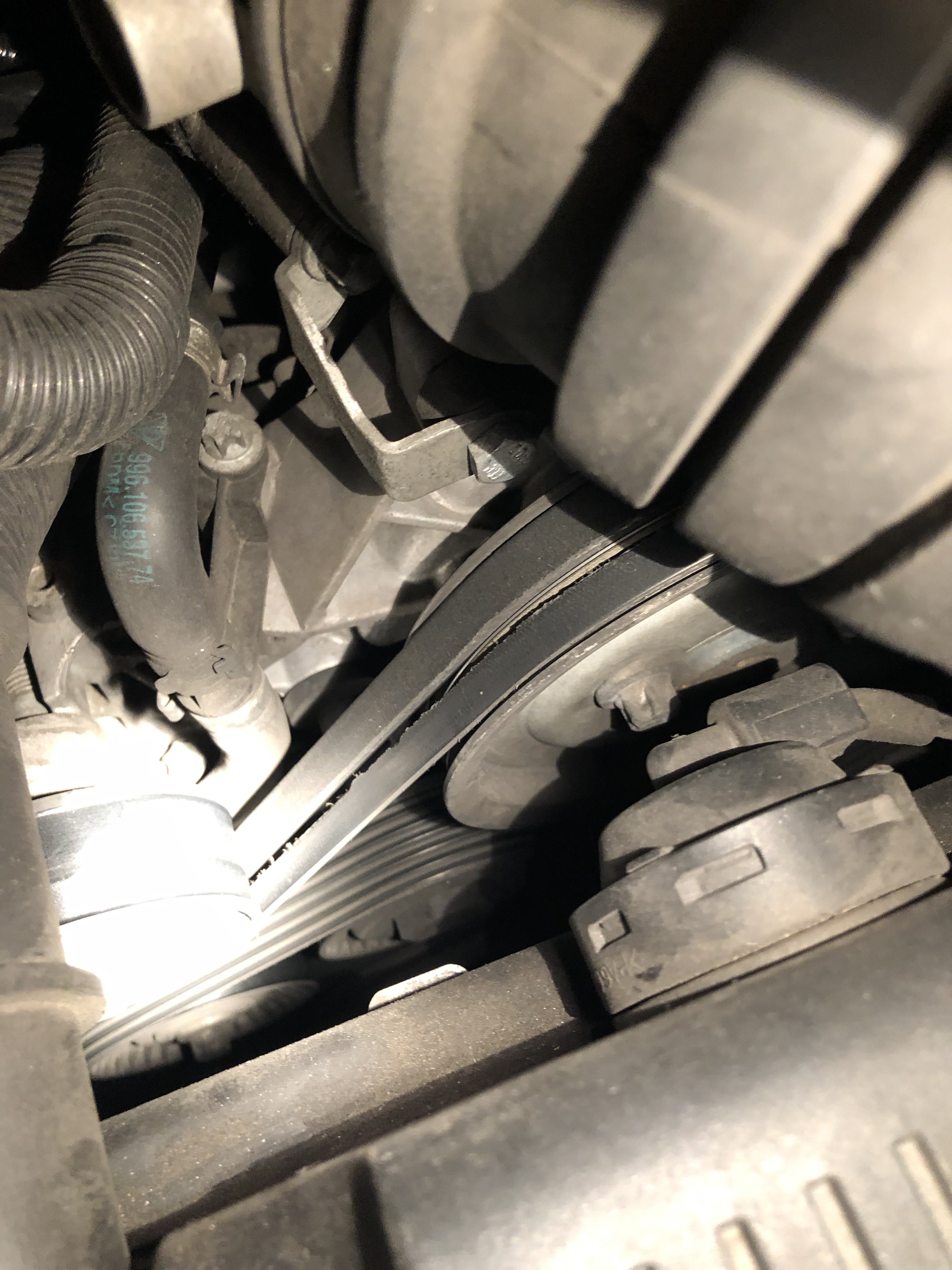

Does anyone have an idea what would cause a tear like this in the accessory belt? It doesn't run the entire length of the belt, probably more than a foot though. I'm going to change it out tonight or tomorrow, but I'm curious if this looks like just a defect/old belt or perhaps a foreign object got in there? Anything else I should check while replacing it?
One of two possibilities:  Normal wear, or the car was fitted with an incorrectly sized belt at some point.  Change it out with the correct part and you should be fine.
To close this out, I replaced the belt today. This was a really easy job. Just needed a breaker bar with a 24mm socket (for the tensioner), a screwdriver to remove the air box from the throttle body, and a pair of needle nose pliers (which made removing the Mass Air Flow sensor easier).
While I had the belt off, I spun everything (that was supposed to) to ensure they behaved properly (found a YouTube video), basically, they shouldn’t spin freely but almost immediately stop due to resistance (makes sense when you think about it as they power different things).
