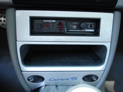

So here is what I did. I installed the remote display and on/off/volume remote in one of my cubby spaces, using the OEM CD holder surround. I had to get creative using foam tape and picture frame insert to trim everything out.
