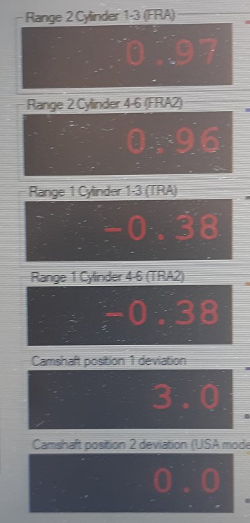

OK....Ahsai your a genius!! I reset the DME and lo and behold. Bank 1 is +3 Bank 2 0. Drove for about an hr and no CEL so far. Now when I checked it before driving, it was solid 3 and 0 no fluctuation. After driving for an hr or so I checked it again and Bank 1 was fluctuating between 3 and 4 for the deviation, Bank 2 was steady at 0..I did replace the IMS so I'm not sure what thats about. I also may have a pending code for o2 sensors on both banks. What do you think. I added pix of fuel trims as well. Thanks so much for hanging with me and helping out! V1235841283_Deviation2.thumb.jpg.5068a51eb42ac143bf8768c89c1216b0.jpg
Glad to hear some good news! Those numbers look great and are all well within specs.
Not sure about the cam deviation jumping between +3 and +4. What I found odd is the cam timing values should have decimal points but yours seem to be always something point zero.
Maybe somethings goin on w the software or the OBD plug, I purchased as refurbished from durametric directly. I've been reading that fluctuating cam deviation is a sign of a failing IMS.,should I be worried about this? Could i have damaged the IMS shaft when hammering the new bearing in? Its odd I ran it again and it was stable at 3 again for a good while then started dancing again.Software also said i had P1123 and 1125 code but I had no CEL didn't specify if it was a pending code. Then I tried to activate the CEL w software and it didn't light but it does light when ignition is in the on position. Seems like I fix one thing and 5 more things go wrong. v
Don't worry too much for now. Just drive the car a few days, let the DME fully adapt and read the fuel trims again. P1123 and 1125 means both banks are running rich. Could be the MAF. Let's wait and re-measure first.
