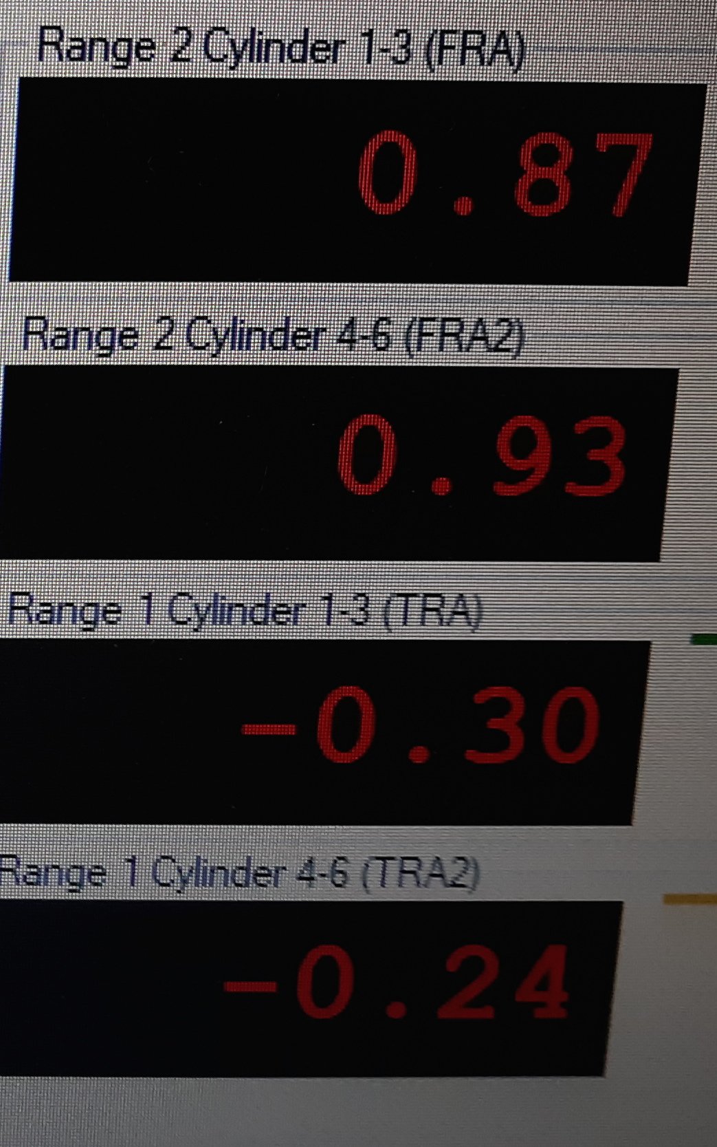

Hi all, Well got my Durametric on today...Seems that I have -15 degrees deviation on Bank 1.Bank 2 reads 0 deviation. I think my fuel trims look ok (just a guess,didn't find an option for RKAT) somehow they didn't move at all when at 2500 rpm's. I activated both Actuators and heard a engine note change so I believe they're both working.I disabled my injectors one at a time and noticed there was more of a change in engine note with 4-5 and 6,not much change when 1-2 and 3 were disabled. How do I monitor misfires in real time?? Any thoughts would be appreciated. Thanks V

Excellent. Bank 1 cam deviation is way out of spec, which is 0.0 +/- 6.0 degrees and you have -15 degrees. I believe that's the source of your bank 1 random misfires. The solution is to re-time bank 1 and replace the cam pads if they are original/worn out.
Both banks are running RICH under load based on the FRA readings. FRA in bank 1 is a bit low at 0.87, which means the DME is reducing the fuel by 13%. Bank 2 fuel is reduced by 7%, not too bad. The bank 1 FRA could be a consequence of the excessive cam deviation.
TRA1 and TRA2 numbers are in % and they look great. So it seems no intake air leak.
For monitoring misfires, go to DME actual values and select "Misfire cylinder #1", "Misfire cylinder #2", etc.

Ok...retime bank1.Are the trims supposed to move when the engine is revved...nothing changed.What cam pads are you referring to? The 2 small pads on the actuator? They were done already. Thanks for getting back.v
Share this post
The TRA should vary a bit when you rev the engine. The FRA is more long term adjustment when engine is under load so just revving the engine a bit won't make FRA move. You have to drive the car but even then you may only see small changes day to day.
