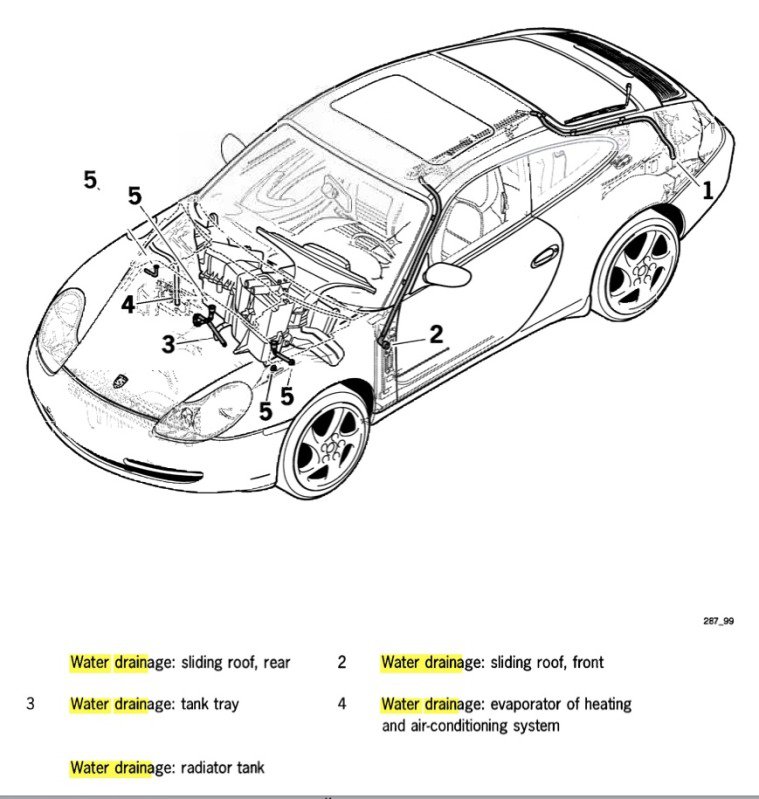

Pull back the carpet against the front firewall in the passenger seat footwell.  You will see a small drain hose connected to the bottom of the HVAC box.  Undo the clamp and can undo the hose and blow it out with some compressed air, or run some trimmer line down through the drain hose.  Also a good idea to clean out the HVAC drain pipe as well. Reconnect and you are good to go.
The other important drains are located to the left and right of the battery tray in the hood.
