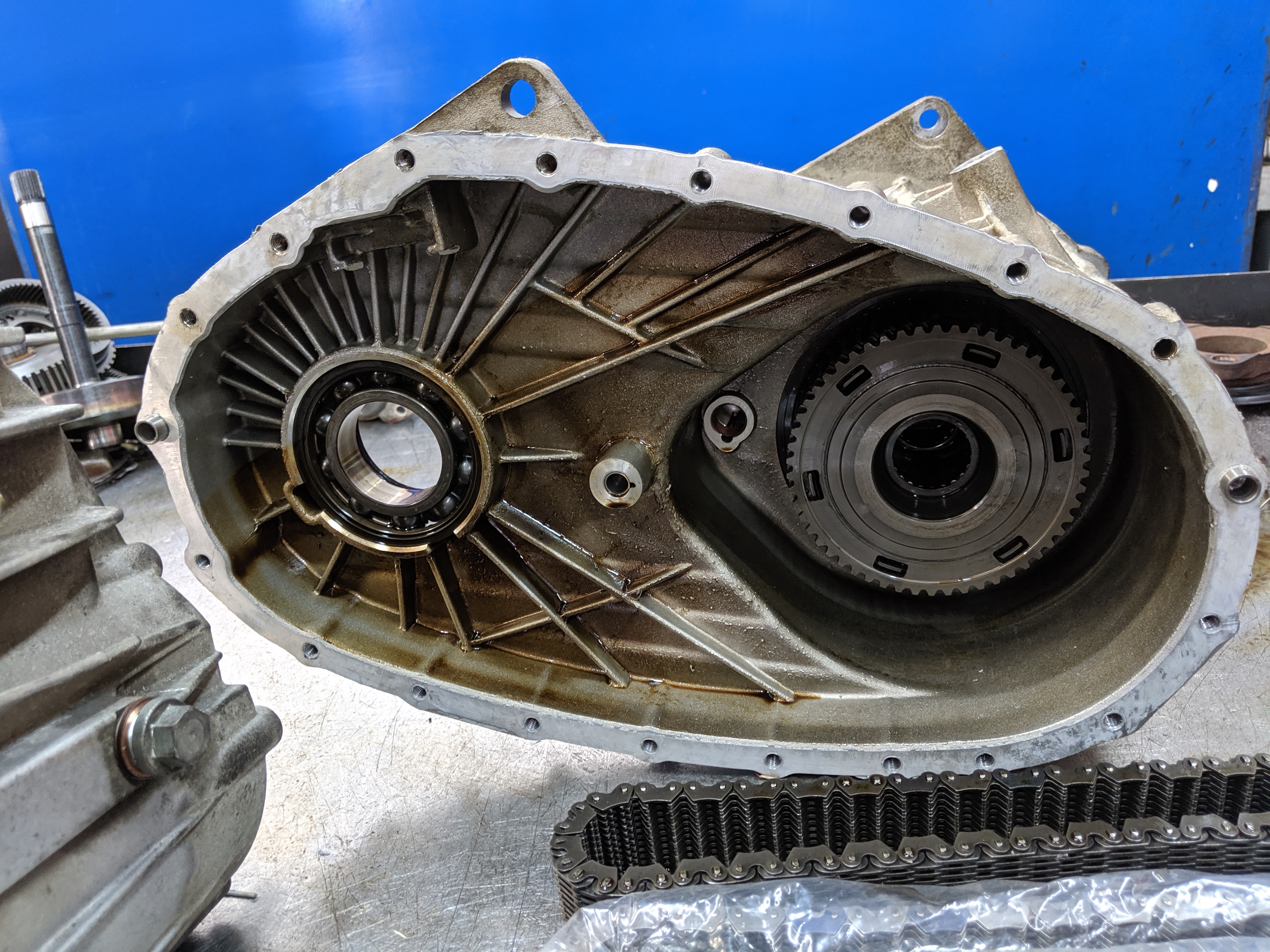

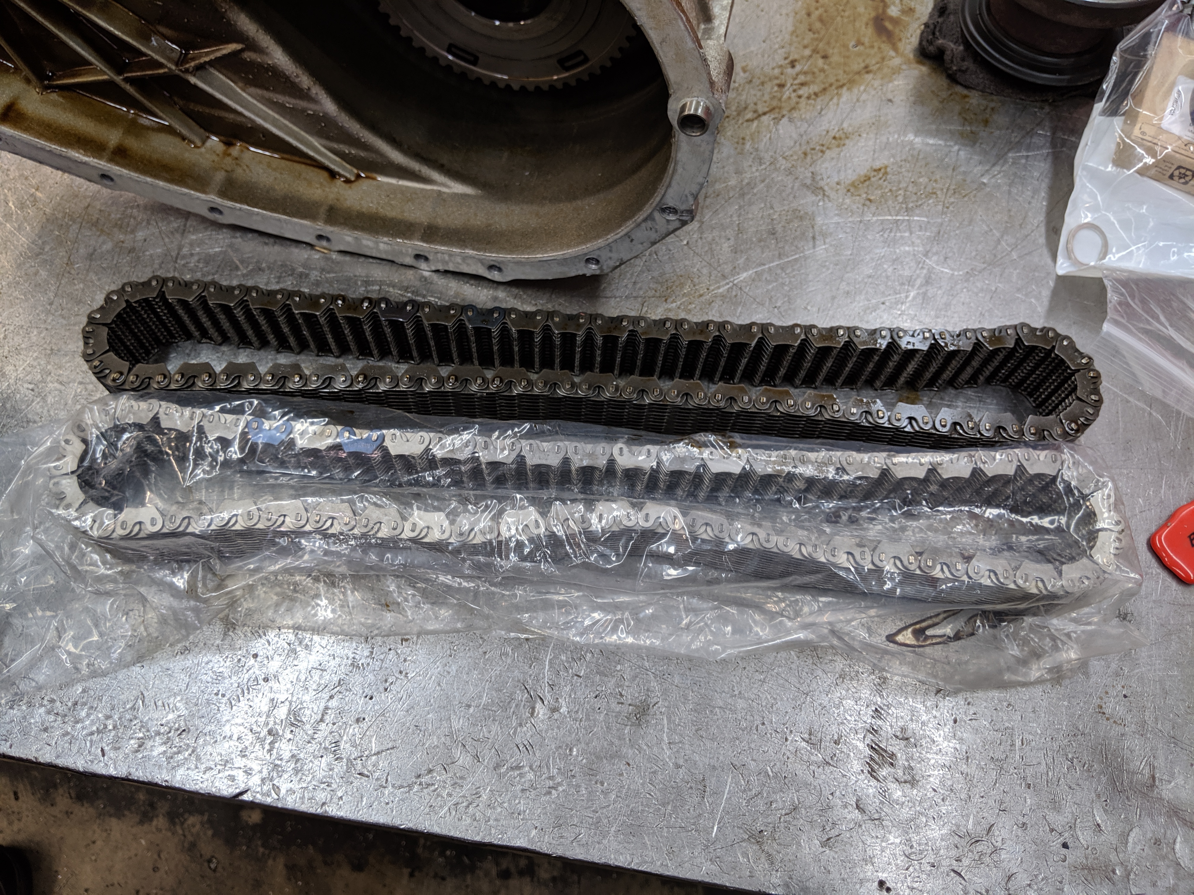

To answer my own post - a while after posting, I found a local transmission shop that had the smarts to figure out the problem. The guts of my transfer case was made by Borg Warner according to the transmission shop.  I found replacement seals and belt at
COBRATRANSMISSION.COM
Are you looking for the best NP 235 Transfer Case Kits for sale? Shop all NP 235 Transfer Case parts today at Cobra Transmission.
  The noise I was hearing was due to the belt stretching out over the years, and hitting the inside of the transfer case housing under load. Here are a couple of pictures of the inside.  In the almost 2 years since I had the transfer case rebuilt it's been problem free
