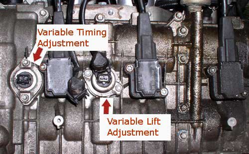

I am hoping its the solenoid. As its an 03 , the solenoid is removeable without removing valve /cam covers.
Any have experience of this ? Is is the one furthest outboard when looking at the valve cover ? There are two, one outboard and a second between the coil packs ?

Many thanks. I had a look last night and the passenger side one cannot be removed without removing the exhaust but drivers side is no problems.
I am assuming the variable timing solenoid first ?
David
Yes because that's what the error code refers to. The variable lift solenoid has its own error codes.
