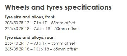

I have a 2001 Carrera 4 Coupe and I want to put winter tires on it in the late fall this year.  What size rims should I buy, 18 inch or 19 inch?  What type of tires do you suggest?
Also, does it matter how many mm offset I get?  When ordering 18 inch rims I can choose an offset of 40 mm, 50 mm, or 53 mm for the front wheels, and 63 mm or 65 mm for the rear wheels.  What does this refer to and is there a specific offset I need to order to fit my car?

Both 17" and 18" wheels will fit your car.
Factory 17" rims are easier to find since most owners seem to want to go up in wheel size and have fitted 19" and even 20" wheels to a 996.
My 17" Carrera2 wheels are listed as 1/2" narrower in front and 1" narrower in rear than my 18" Carrera wheels, presumably for clearance to fit cable chains.
Many of the factory wheels floating around are from Boxters and are even narrower so beware of sellers saying that they are a correct fit your 996.  Check the width.
