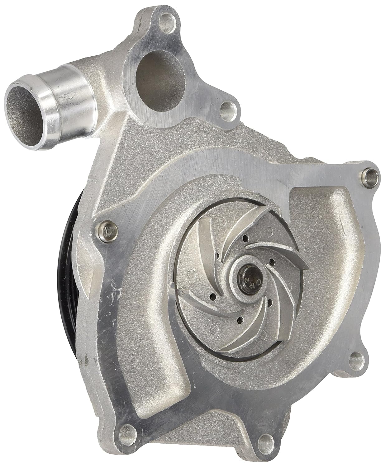

I believe the Gates pump has a metal impeller:   I am concerned that the pump was replaced because of overheating, not because the pump had failed or was making noise.  The question is

People have a tendency to replace the composite impeller pumps in these cars with aftermarket metal impeller pumps because they are cheaper and people think they are better, which is a big problem.  The clearance between the back of the impeller and the engine case is only a couple thousandth's of an inch in order to get proper coolant flow, and Porsche used composite impellers specifically because as the pumps age, the shaft begins to wobble and the impeller hits the engine case.  If the impeller is composite, the impeller breaks up and fails; if the impeller is metal however, it begins machining away the engine case, creating a much larger gap, and renders any new pump, regardless of impeller type, unable to move the coolant in sufficient volume to keep the engine cool.  Unfortunately, there is no coming back from this a the engine would have to come out and apart to spray weld up the are and then be machined to the correct tolerance's, which is too expensive to be realistic.
Yes, pulled thermostat and tested good. I have the paperwork from the water pump. It says 42579 which comes up at Gates brand when I do a google search. The photo shows metal impeller but people are “complaining” in the reviews that it is plastic, so who knows... hopefully composite?
I am concerned that the pump was replaced because of overheating, not because the pump had failed or was making noise.  The question is why was it overheating?  At this juncture, if the car was in my shop, I would pull the water pump and look at both the impeller and the wall of the engine case.  If the case is tore up, you are chasing your tail trying to get the system to work.  As for the reviews of the pump, some "complain" the impeller is composite, others complain it is metal, so it sounds like they could go either way.  In any case, we ONLY use the factory water pumps, which are all composite impellers, and work well, unlike several aftermarket brands we have looked at.  Unfortunately, many aftermarket bits for Porsches are really junk; water pumps, surge tanks, and AOS units are great examples of what not to buy.  We have seen several fail right out of the box.  Yes, they are a few bucks cheaper, but after some people have gone through two or three units in quick succession, that few bucks looks like a really bad deal...…..

As for the Gates water pump impeller being metal or plastic...
I found reviews prior to May 2017 saying it is metal and after Jul 2018 saying it is plastic.
Mine was installed in May 2018 so it will definitely be a surprise.

I called two wholesalers that handle Gates and aske them to look, one said metal, the other composite.  I think the Gates is a 50/50 proposition.

Got a FREE new Gates pump under warranty. Tried to install it and ripped the cardboard gasket, ****. Nobody local sells  water pump gaskets for this car. Nearest dealership is one hour away so I got a new Porsche metal gasket.
Went to install the new Gates pump and it seems like the impeller is binding. There is resistance when I turn the pulley and a blockiness to it at certain positions around the clock. Definitely rubbing/contact. I didn’t have the screws tightened down all the way (didnt want to ruin the new gasket) but even so, this seems not right. Confirm?

Just get the factory unit and be done with it.  Piersburg is supposed to be a supplier to Porsche, but the units I have seen in the aftermarket do no look the same.
I put in a Pierburg and it is working great on initial test drive. I have nothing to compare it to except the Gates pump.
Gates pump is complete garbage!!! The impeller bearing is mounted off center which as causing the binding. On top of that, the impeller was out of round. On top of that (!) the impeller was mounted too high on the bearing shaft. So it rubbed on the tips at first. I filed them down. Then it rubbed on the top edges when the screws were tightened down. Completely unusable piece of garbage! I don’t even know how they can get by selling it. No wonder the brand new gates only lasted 600 miles before it shredded.
Also, the impeller is totally different material. Cheap molded plastic on the gates and the Pierburg has some type of composite material that seems almost metallic.
Pierburg had a couple pieces of slag (not sure what to call it) that was from the casting. It didn’t look like that great of a casting job. I chiseled off the little bit that was on the inside where the water flows. There were a couple blemishes on the gasket surface too that I sanded down with 600 grit just to be safe.
Maybe they are seconds that don’t meet Porsche quality requirements. Said made in Italy and had a 996106101 part number.
Thank you so much for all your help and I will be back so you can say “I told you so” if this pump fails me!
I sincerely hope that day never comes.  But you have shown why those of us that fix these things for a living regularly tell people to stop trying to cheap out with aftermarket components; your Gates pump is a poster child for why we say what we do, and why we depend upon factory parts.
