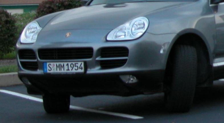

I just fitted a standard German front plate to my S, dealer tells me that this is responsible for failure of my Park Assist system.
Going by photo's I mounted it as close to a German S as I could get.
Anyone know of this problem or the correct location and mounting arrangement for a German or indeed a UK front plate.

When I blew up a factory taken digital (ngfan) I think I can see it now.
Any idea where I might get one in the US or should I just order from europe ?
