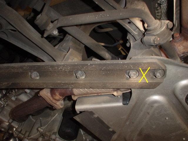

This (of course) raised another question. Where do I place a jackstand (for safety while I'm under the car), if I already have the jack in the left rear jacking point?

You put the safety stand where the yellow X is, and the picture will make no sense to you until you jack the LR and remove the tire. You only need to do this on the LR/Driver's side. We never jack up the passenger side.
After your stand is in place then you lower the jack so that 98% of the weight of the car is on the stand. I never remove the jack when the weight of the car is on the stand, but leave the jack in place, just in case. When you place your body under any car you do not trust your jack and since I am in earthquake country and sometime work on a sloped driveway I do not even trust a stand. Sometime I will even slide the just removed wheel under the car so that it will be next to my body and under the car. The rim is larger than my head and chest.
