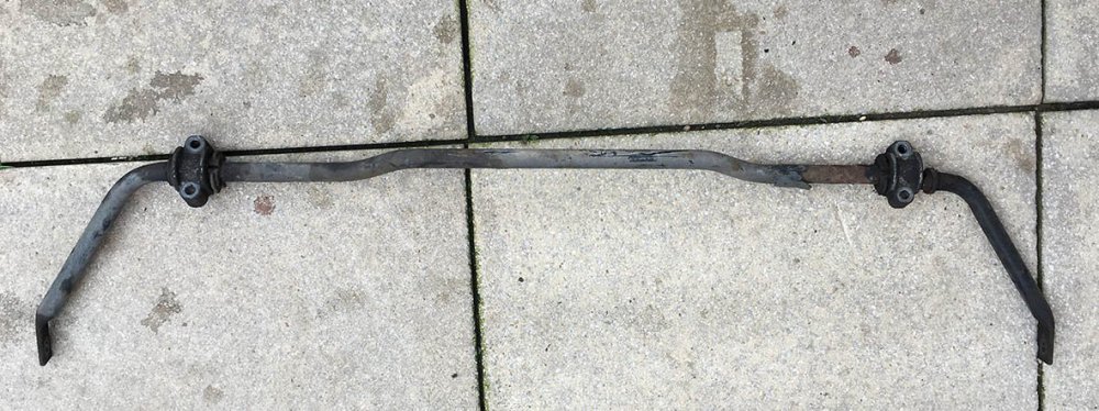

Can anyone tell me for sure if a rear anti roll bar for a 987 will actually fit a 2003 Boxster 986 3.2S.
I have been struggling to get hold of one for my 986 and the anti roll bar for the 987 looks identical
Just wondered if anyone knows
The pic attached is off my 986 anti roll bar which has broken at the joint.

There are different order numbers for a 986 depending on motorization and whether or not sport suspension, this will be the diameter of the anti roll bar. The 987 has completely different order numbers starting with 987-***-*** and also motorization, sport and/or active suspension. I don't know if this is interchangeable.
