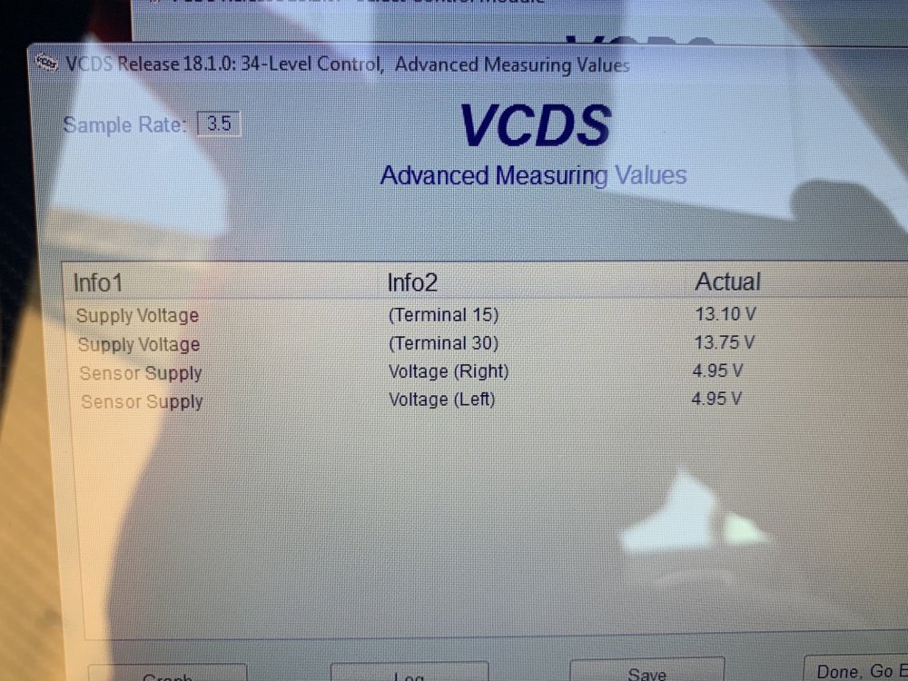

ive cleared the faults and was able to see voltages of around 2.40v for these sensors then all of a sudden they lose all power get 0v and the Air Suspension fault comes back.
this happens even if I don’t drive anywhere - just wait and eventually the sensors lose power and I get the error

It doesn’t make sense cause when I first start the car I get voltage signals on those pins and can even see that in the diagnostic software - but give it anything from 30 seconds to 5 minutes it all of a sudden loses the voltages and goes to zero and the error comes up
wjy on earth would it initially all be good and then for no apparent reason lose the power supply? Without the car even moving!!
