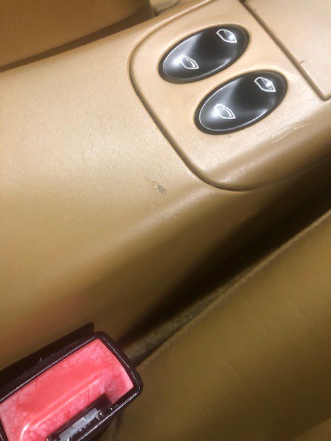

Repairing center console scratches
I don't know if anyone has done any repairs on scratches on their center consoles, but I have a couple on mine I'd like to fix.
If you have, I'd be interested in how you did it and how it turned out, short of taking it completely out of the car and respraying.
