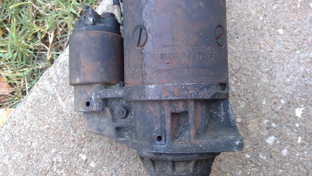

After getting weaker and weaker and giving me a few push starts, the starter on my 1985.1 944NA has now finally given out. It is a large diameter Bosch starter with the markings 047 911 023A.

You can have the current starter overhauled at a Bosch center, spare parts are still availlable. This is a cheaper solution and remains original, collectors of classic cars do this all of the time.
Followup: I replaced this with a newer SR39X small diameter starter, which works.  I did discover after this that my original Bosch starter is actually good (both car batteries I tested it with were not).  The difference between a direct drive (original) and a geared (small diameter) starter is significant.  I like the feel and sound of the direct drive starter and I'm might swap it back in.
