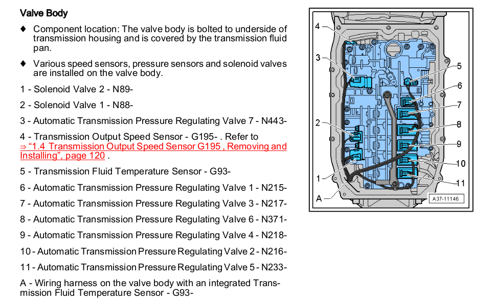

I found an issue today, it's N89 solenoid. Resistance is only 5 ohms, should be in the range from 11 to 15.
Now big problem - where to find it? Cant find anything for 0C8 gearbox, the only similar is for Audi Q7 2012 off ebay hope it will fit

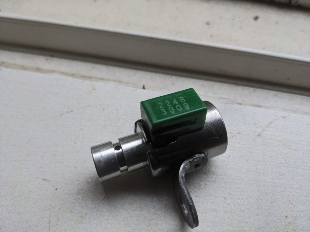

Picture of burnt solenoid (you can see burn marks on connector as well!):

At first I could not find this green solenoid anywhere. A black one which is right next to it is totally similar to shift solenoid from another AISIN transmissions used in VW / Jetta. I bought it and tried in place of green one. Bad decision! Transmission was out of limp mode but shifted really badly, with big delays going to each gear.
I finally found a whole assembled valvebody with all solenoids from broken transmission parting out, replaced both black and green from it to my transmission and everything is perfect! It shifts better then new.
