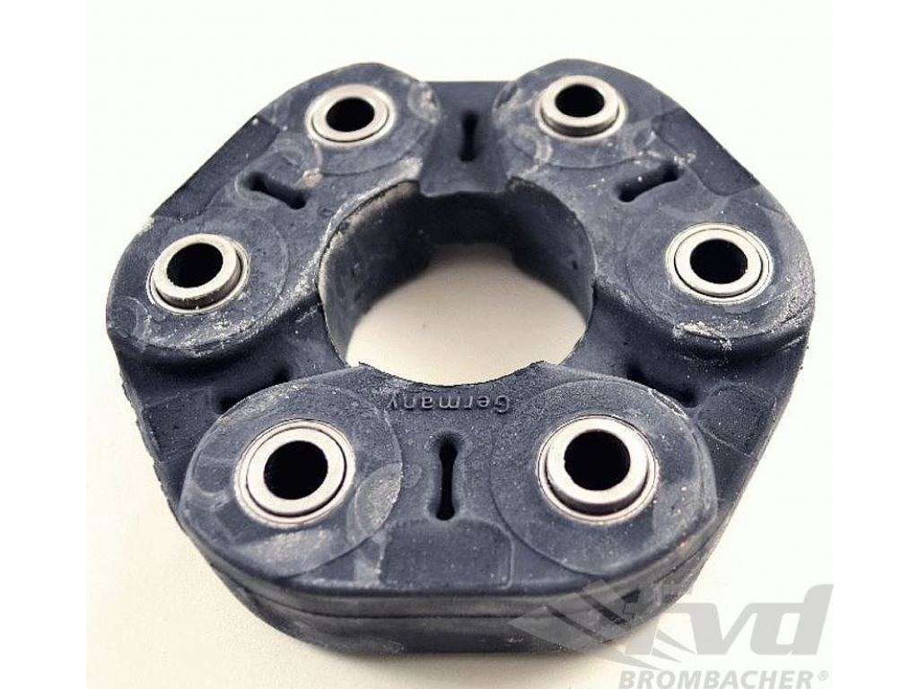

Check your flex disc first.  I have an '03 CTT and what my late mother called a "leadfoot".  I've replaced the cardan shaft/bearing assembly twice and recently thought it had gone again.  Turned out to be the flex disc which had been replaced both times, but failed with only a few thousand miles on it.
