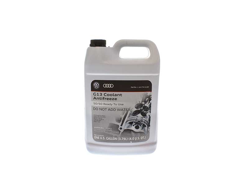

It's interesting that Porsche recommends mixing their OE coolant.  I know they are under the VW umbrella technically now and I just looked and my 2.0T coolant came premixed 50/50.  It's more expensive to buy this OE coolant but, as I mentioned, after being burned for $5K on a gearbox due to someone else's mistake it has made me think twice about trying to cut any corners whatsoever (which is something I never did much of in the first place but I know some people think I'm crazy about OE fluids/parts but once bitten twice shy).
