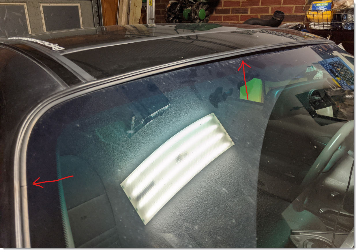

I have a 2004 996 Targa and the rubber gasket that runs around the top and sides of the windshield pulls away from the top of the glass any time I drive over 50-60 MPH (see the top red arrow in the attached photo).  There's also a metal strip running through it that appears to have cracked in half (see the left red arrow in the attached photo).  I've searched all over the place, but I cannot seem to find a replacement part...  Only random rubber gaskets.
Can you guys help with a part number and/or a place where I might be able to get a replacement?

I had this and ended up having to replace the window as the inner stop is bonded to the glass, not cheapi had a similar issue and as the strip and inner seal is bonded to the glas s it need a whole new screen, they were not for me separate replaceable itema
  • Like 1
996 541 531 01 Sealing Frame - US MSRP $47.27
996 541 541 02 Decorative Frame - US MSRP $82.22
Be sure the correct adhesives are used when sealing.
Porsche sells (an expensive) kit 000 043 305 35 US MSRP $169.67
Many here have had a good experience with Safelite.
