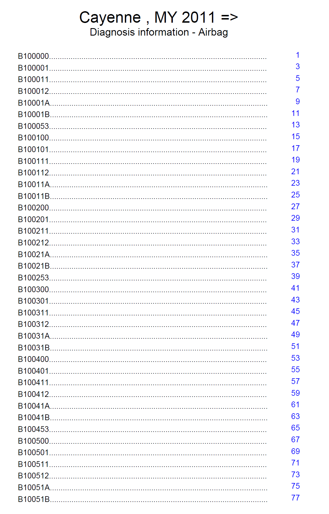

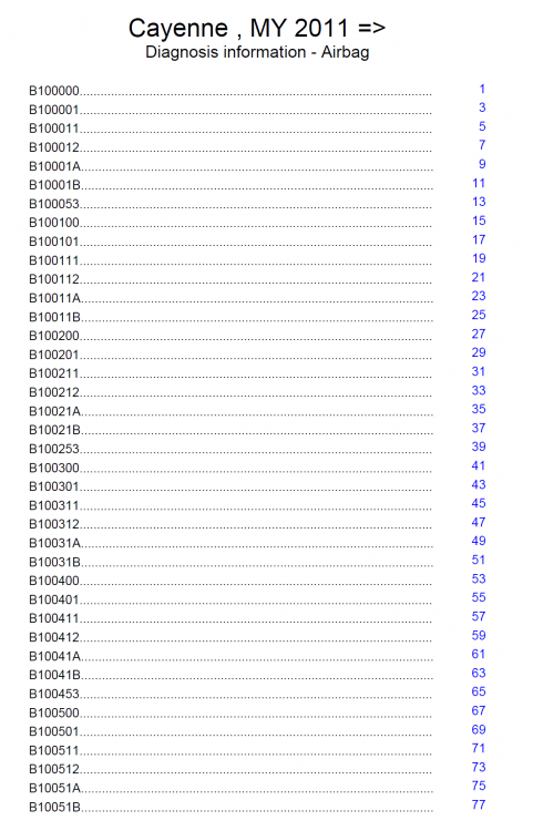

Hi, My airbag light recently came on and I was able to pull the codes. But the information isn't too helpful. I searched the internet, the results were mostly in Audis, They have similar codes. I am wondering if the members here could help me decipher what these messages mean. Thx
Car is 14 CTTS
Edited by Loren
Made image viewable...
With a different scanner. I was able to get.
B10001B - Driver Airbag stage 1, Limit Value Exceeded
B10011B - Driver Airbag stage 2, Limit Value Exceeded
hopefully this helps
