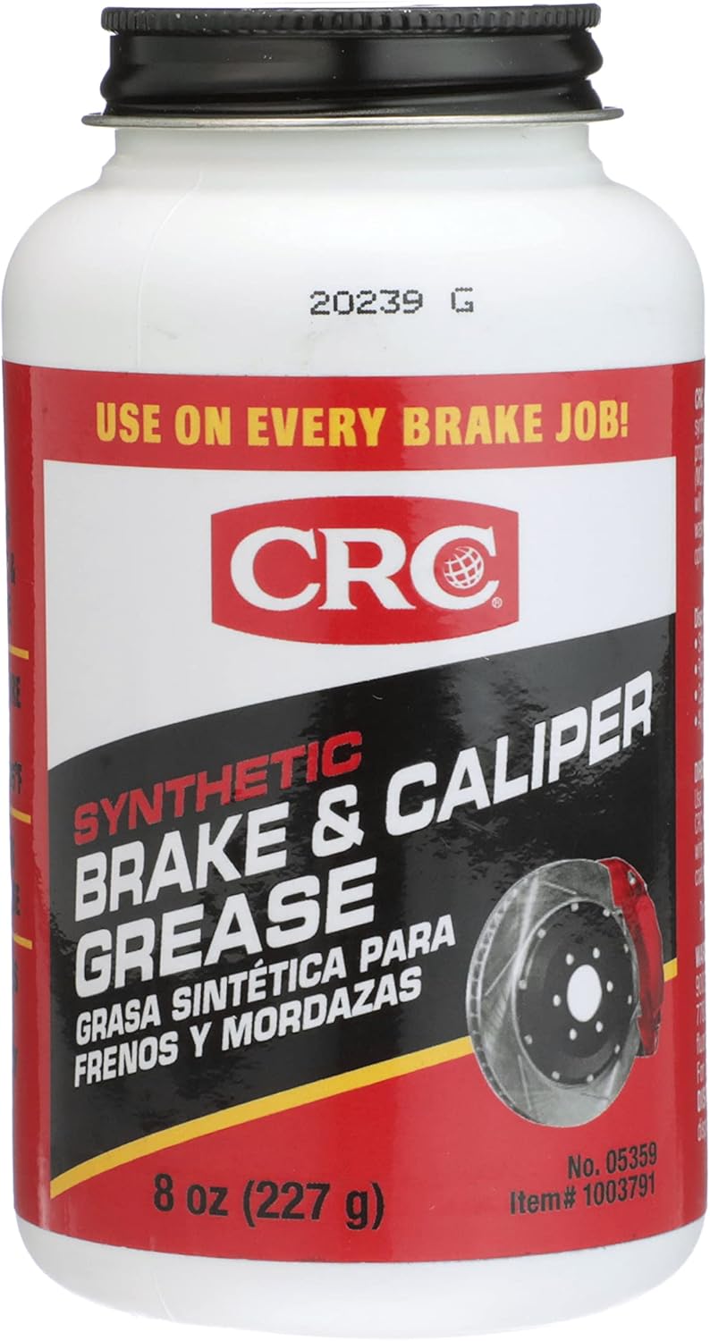

The internal gears use a very heavy grease due to the temperature they see and are not good candidates for the Teflon spray lube, if anything I would use silicone-based brake grease is they need to be re-lubed as the brake grease is also for high temp applications. The Dupont product is only to be used on the shaft and internally on the gear of the Bendix shaft, I just checked Wal-Mart, and they are listing the Dupont product in stock with one day delivery locally, so you might want to look at other sources. As I am not familiar with the other products, I can't really recommend them.
