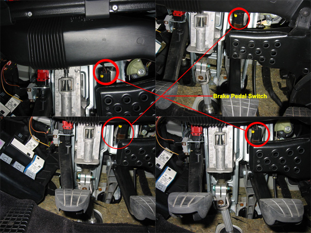

Okay, I took pictures of right above brake pedal and I can only assume that little yellow thing is where as you've describe as 90 degree and twist?
here are some of photos (4). let me know if I am looking at wrong item.
Look above the brake pedal.  If I remember correctly it locks in with a 90 degree twist.

That's indeed the part. It's brown plastic on one end and black on the other. Twist 90 degrees and then you can pull it out. It's kind of a pain to get to with your hands because there's so little space. If I remember correctly, I think you can temporarily move or remove that black plastic part with the swiss cheese holes in it. When my brake contact switch went bad, it turned out that the inside was gummed up with grease and dirt, making the electrical contacts not work. My brake lights would just give one faint momentary flicker when I braked.

Cool. thanks. that did work just fine.. twist 90 degrees and pull it out.. cleaned it and work like charm. :drive:
Thanks again.. and no thanks to dealer.. ripp off. :soapbox: total time of repair... 25 min.. compare to 4 hour estimated by dealer.. hell no. :clapping:

Once rotated 90 degrees, the switch (attached to the socket and wires) should come clean out of the metal bracket in front of the pedals.
Once you have it out, you should be able to separate the switch from the socket with wires - there are 2 tabs either side of the socket (see photo - these are on the left and right of the socket as you see it).
To clean the inside of the switch, you just need to use a small screwdriver to pry apart the brown and black plastic parts of the switch (or red and black if it's the clutch switch). Be careful as the switch contains a loose spring which is liable to fall out at this point.
