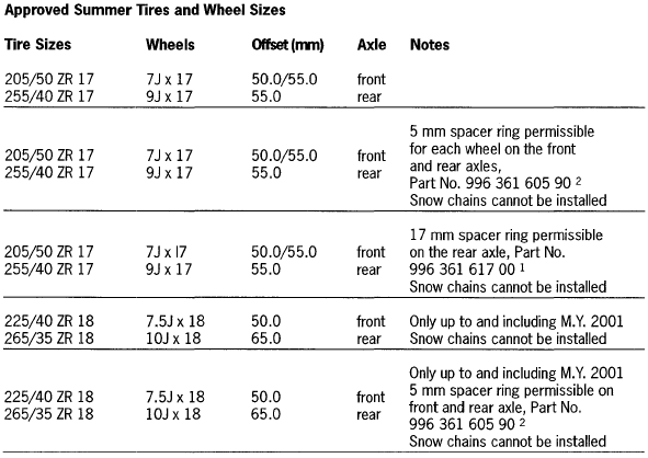

What is the factory offset for this car?
the 17" wheel?
the 18" wheel?
does the 2k3 Turbo hollow spoke wheels fit?
i figure the rears wouldn't fit...
thanks. :thumbup:
"Normal" turbo wheels do not have spacers, the only ones I know of that have spacers from the factory and that can be left out for the narrow body are the Sport Techno wheels.
