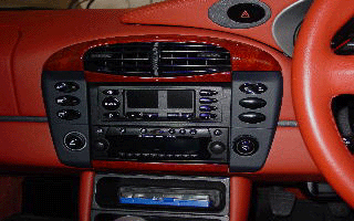

I just replaced my central dash console today. When I took the cigarette lighter out I noted there was a small light. I dont know if this is working now. The dash lights up as normal but the lighter surround does not. I think it lights up when the lighter is hot but it is quite faint.
Am I right? If so then it must be working OK. If not then I may need a new bulb. The lighter heats up fine.
Thanks for any help with this.

I like your mod but I do have a real problem. My mind likes symmetry, so much so that I was thinking of replacing the 2 dummy inserts with real switches (non-functional) to make the console balance. If I were to close off the cigarette lighter (I don't smoke being medical!) I'm sure that my driving would suffer because of the bad feng-shui
