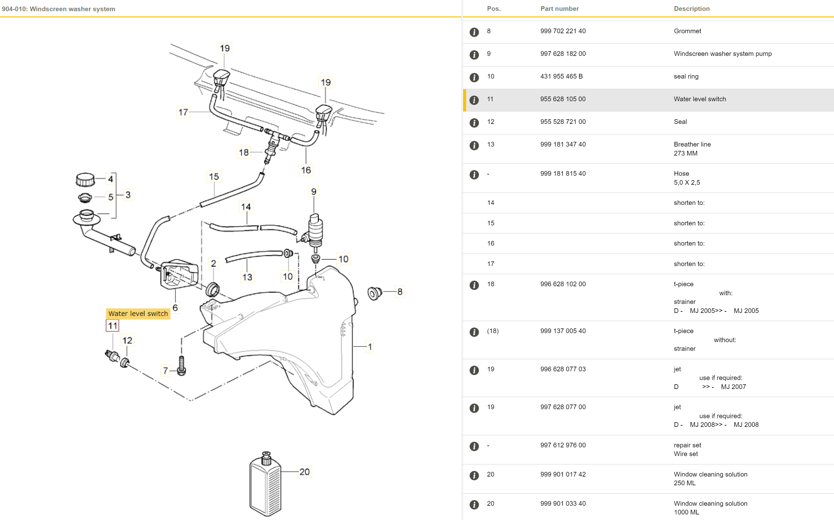

Boxster 987 washer fluid low warning light on ?
There is just a sealing washer around it and the electrical connection.
When you pull the old one out washer fluid will leak out so push the new one in right away. Then transfer the electrical connector. Done.
