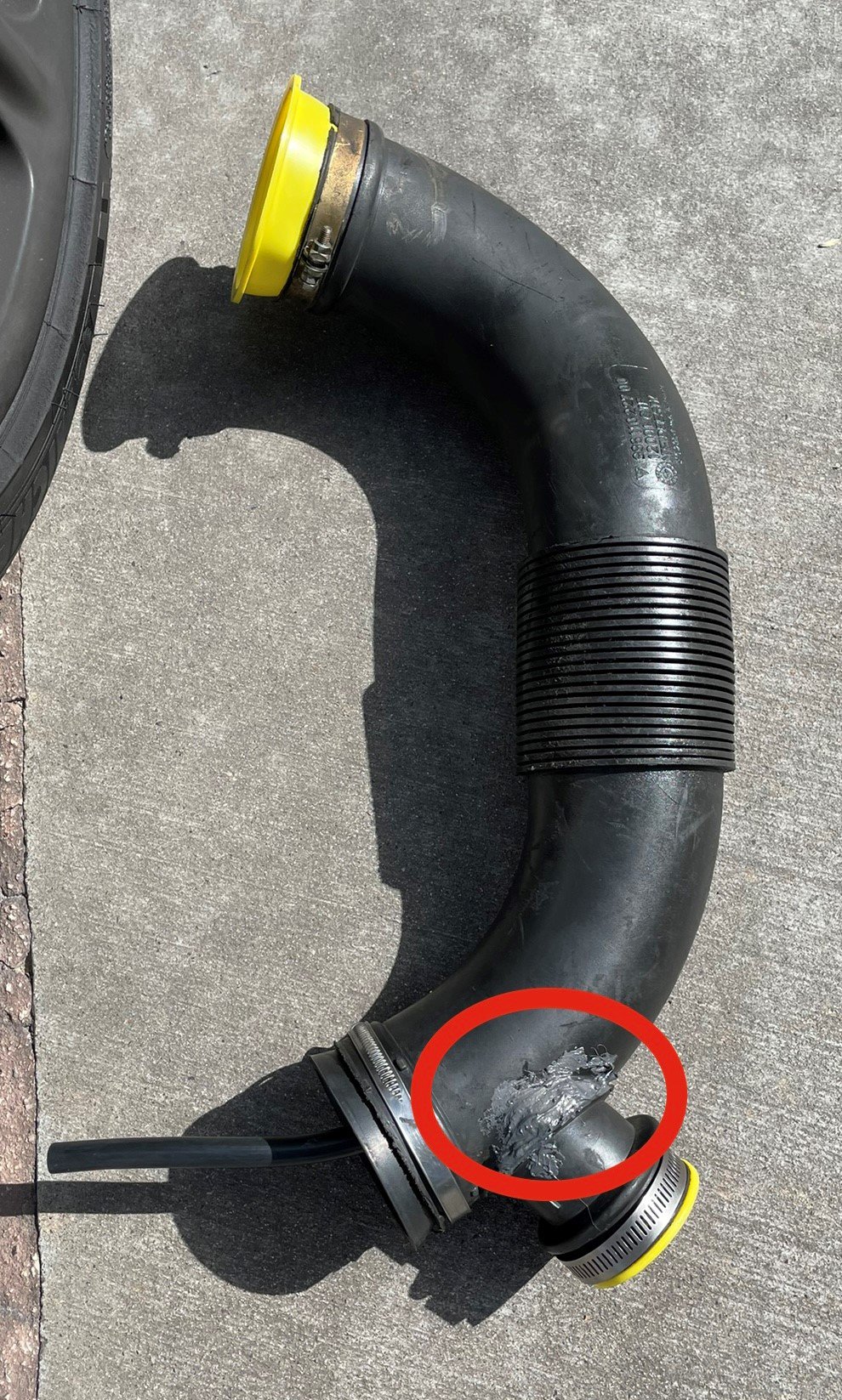

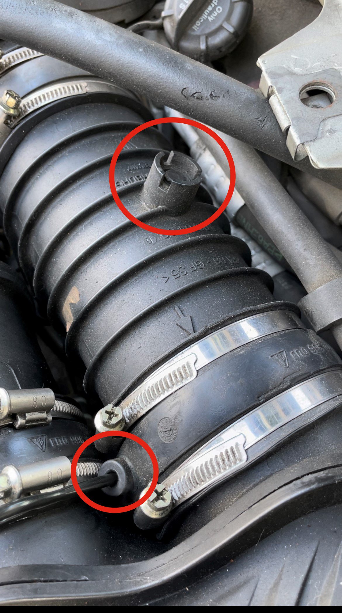

Ok, finally smoke tested and had a couple of findings.  The intake tube had a leak at the location circled in red.  I repaired it with RTV silicone.  Two locations on the intake manifold, also circled in red.  I saw another post about someone having a leak at the place where the internal flap is located, so I'll look into that.  On the SAI hose, I noticed that it does not have the bulge at the end of it like the other one.  Wondering if this is the cause of that leak?
