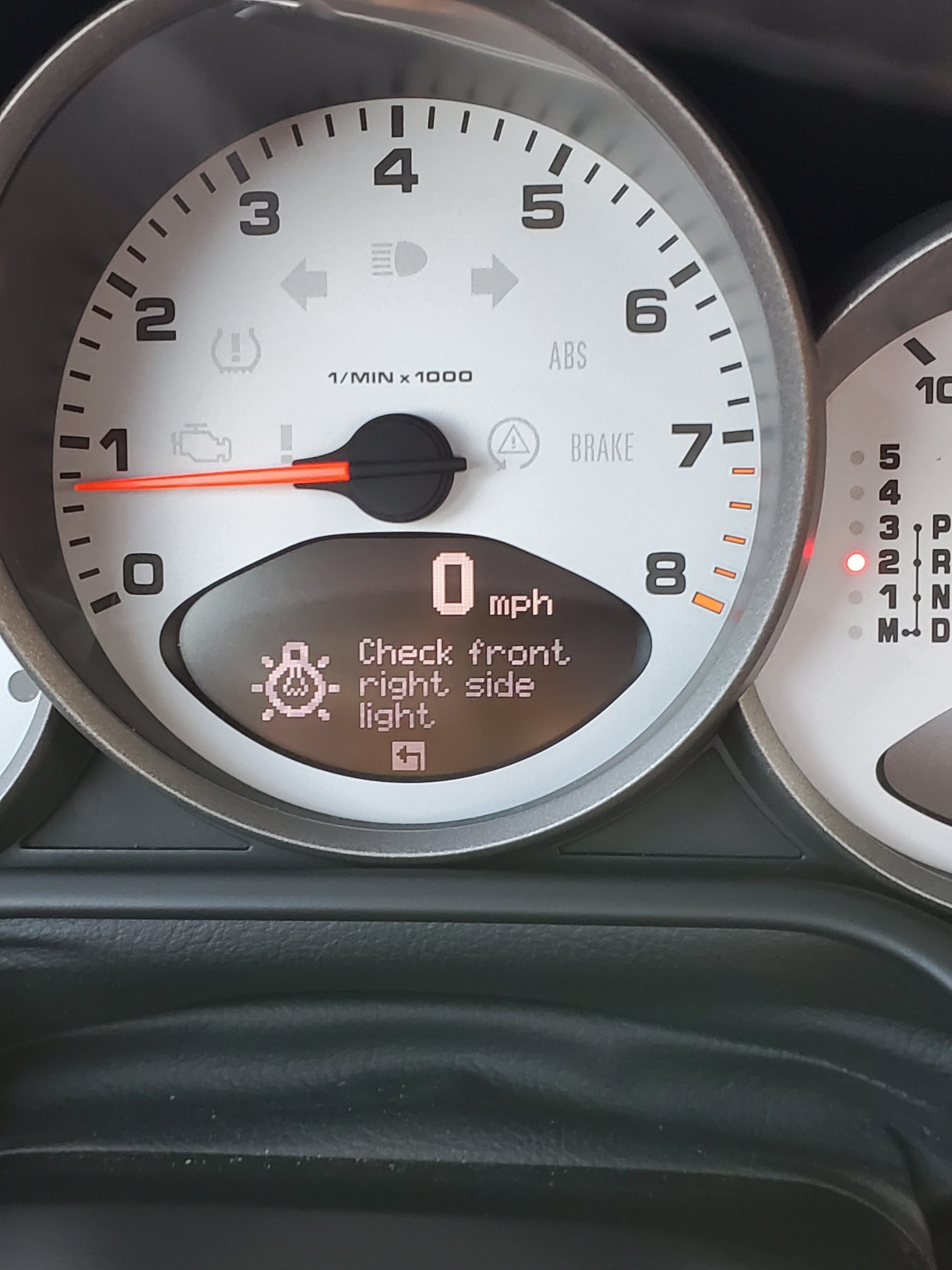

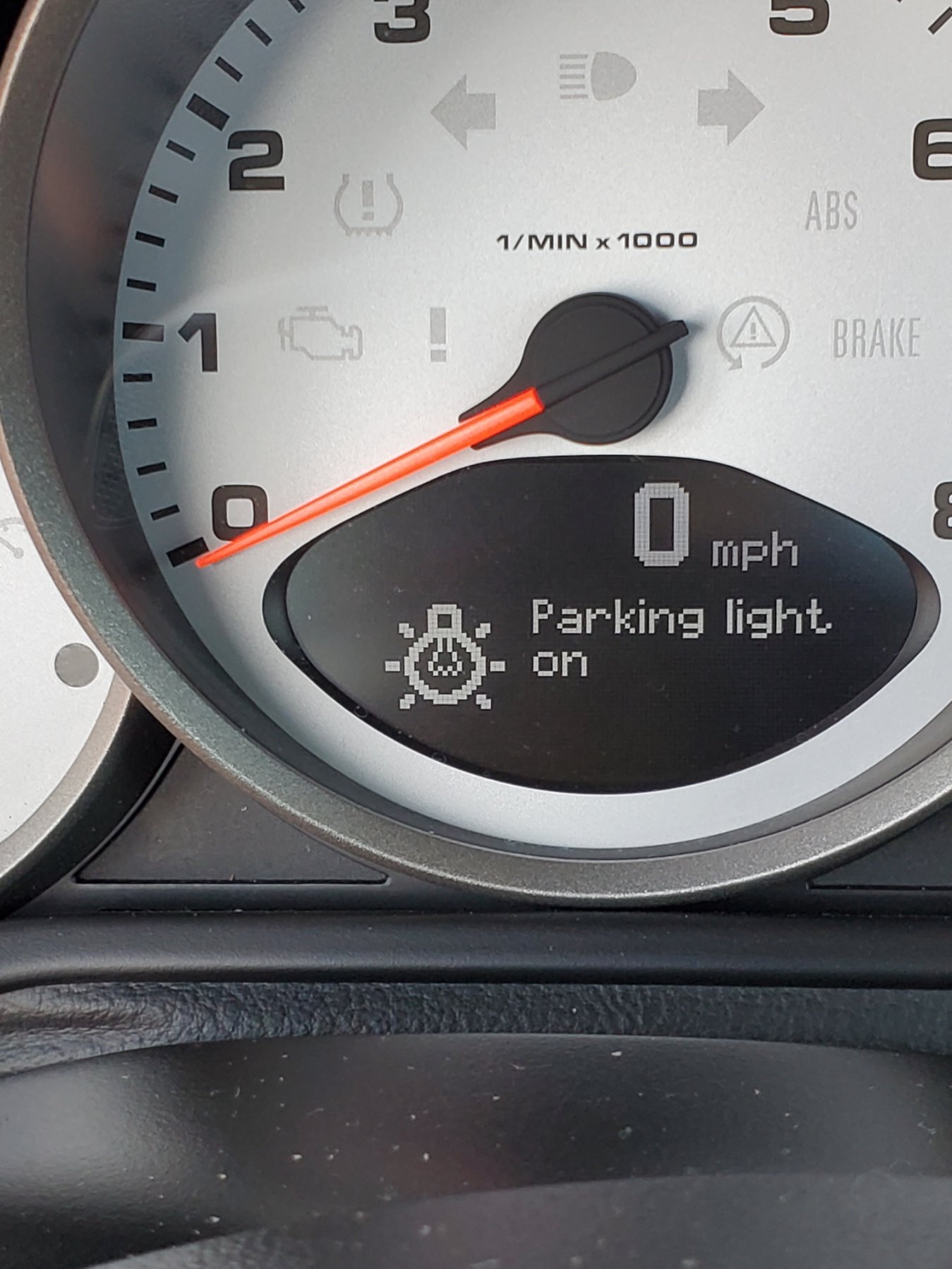

Receiving two different messages: 1. Message to "check right front side marker light."  A.  When checking the R front side marker light bulb is working.  B. Message randomly appears. 2. Message that "Parking light is on," the the Check Engine light will be on.  A.  Parking lights are on when checking. B.  A noise alarm appears that is similar to when the seat belt is not worn by the passenger.   Both the error message and the noise will continue when I exit and lock the car.  The two will continue until I return and restart the car.  Your thoughts and/or suggestion are appreciated.  Thank you.
If you have access to a Durametric or PIWIS you might gain some insight from the error codes the diagnostic tool shows.
Thank you for the input.  I assume that the Porsche shop that I use in Scottsdale has access to that diagnostic equipment.  I will make a point of asking them. At this point they originally thought it was the ignition switch, which they replaced to no avail.  The issue persisted!  Not having sophisticated knowledge about the inner workings of my C4S, I would;d like to resolve the issue without just changing part after part.
If it's a dealer or a Porsche-focused independent shop then they will have the PIWIS.
It might be as simple as a couple of connectors not making the best electrical contact. You could locate connectors along the light's electrical path and then undo them and spray in some Deoxit and then plug/unplug/plug them a few times.

Thanks!  The Porsche shop that I go to is an independent.  I will make sure to mention your suggestions, which makes sense to me, as I do not want to just keep replacing parts until the problem goes away.  Gets costly!
