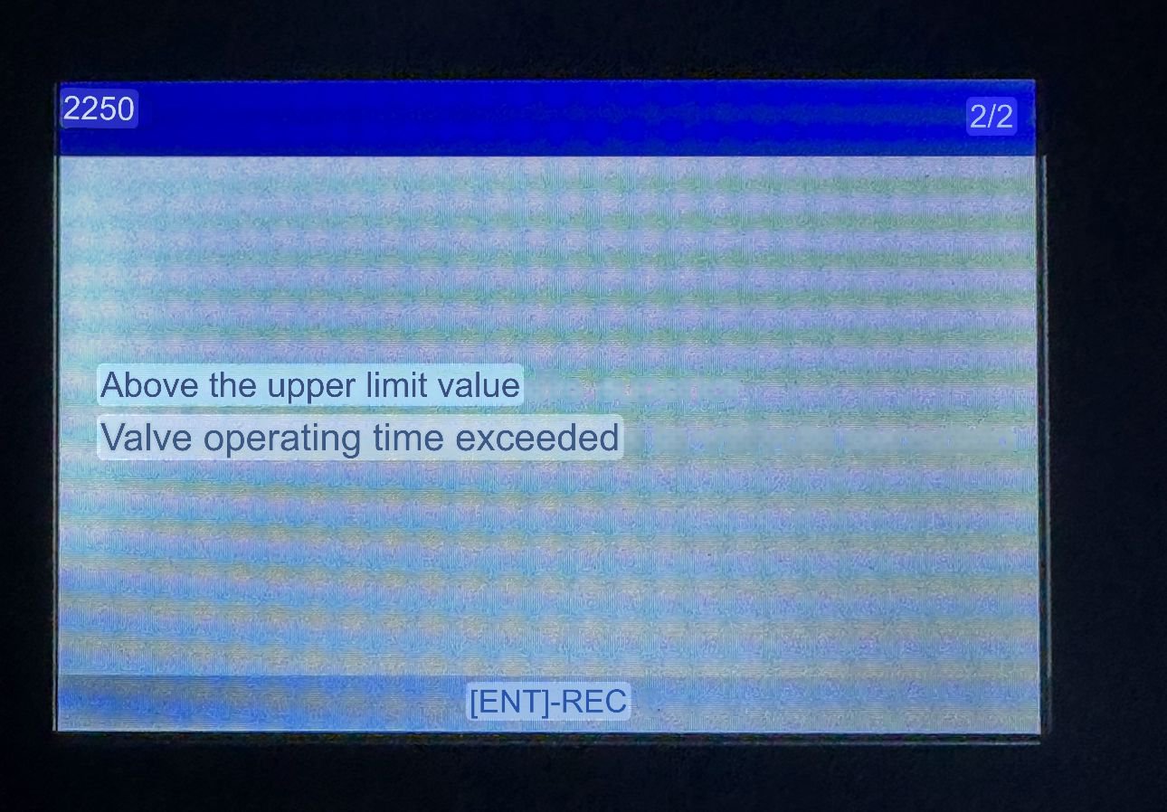

I don’t know if this may help, but eventually between 5th and 9th of May, I got some errors that got cleared, and didn’t came back.
Sorry for Google translation on image.
So car is out of the workshop. They replaced valve block, everything worked perfectly during 120 kms distance, and after refueling, it popped up again chassis system failure, and after that warning chassis system, two fuses blown up again.
Yesterday my icarsoft was registering data. Today car had no error, just a blown fuse after driving again, I’ve replaced it, and when I tried to scan with icarsoft, no data was available, and it’s not reading any data from PASM, but all other parameters (engine and so on) are readable. I’m really frustrated and I just want to throw up the car. Two months, more than 1,5K spent and 0 solutions. And as icarsoft is not working, I can’t check which parameters are wrong, but thanks for your help anyway!
