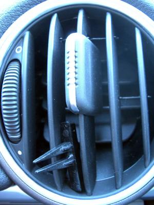

Can somebody please post a picture of the party which in fact is broken?
Thx
Oli
Hi Oli,
I've just joined. I have the same problem and have attached the offending part (well, this was the offending part in my case!)
Regards
Stu

Had one of mine pop out yesterday and I was able to reinstall it. I found it easier to glue the little metal spring back onto the black 'fang' piece first. The black 'fang' piece has the fangs not centered, I placed the piece so the fangs are towards the top. Once that is dry, I centered the vent and place the 'fang' piece onto the center horizontal louver, moved the vertical louvers a little bit and with the aid of a small screw drive walked the fang piece into the back of the vent control. I then used a piece of clothes hanger wire that I place a "U" shape bend in the end of it, to push the 'fang' piece back into the vent control from behind.
I can confirm they can be refitted. I used a small size allen key as they are more rigid than wire and a pair of long nose plyers to initially place the fangs either side of the vent fin. As you say in your post its a fiddly but simple matter of moving the centre paddle to the extremity and pulling the fang back into its position. I also noted that the left and right hand vents are easier to refit with the fins directed towards the side windows as there seems to be more room. You may also note the fang is offset , the offset should be towards the top facing upwards. I didn't fancy having the leather trimmed dash removed for a simple vent and then the grief of creaks and rattles forever more. It may note be a permanent fix (special glue is required for this type of plastic -superglue wont work as its an oil based plastic) but I'd prefer to fix as I go than have the dash apart.
