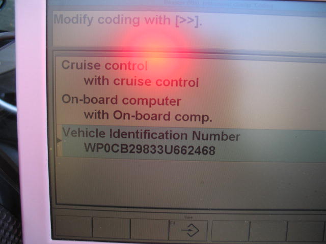

Turned on the OBC and cruise control today on a 2003 S tiptronic made in Feburary 2003. This Boxster did not have OBC or cruise control.
As has been reported, I was not able to change the instrument cluster coding because when you go to that screen it asks for the order type.
Went into the DME and sure enough there was no order type, just 3 dashes ---. Erased the dashes and entered 986320 as the order type.
Started the automatic search all over and then when I selected instrument cluster coding I was then able to see the screen where you can change the coding. Changed the coding to "with" OBC and to "with" cruise control. Then I also changed the DME coding to "with" cruise control. In the picture you can see that the OBC and cruise control has been turned on.
Now the owner needs to buy the parts to complete a dual retrofit.

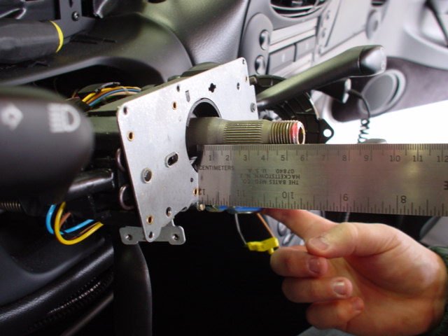

I mark the location of the original stalk assembly on the back before I remove it. When I put in the replacement I slide it on, up to the mark.
If you did not mark it first you can also measure it. It is 55 mm from the metal plate to the tip of the splined shaft.

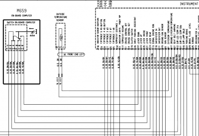

Could some one please tell me what coloured wires from the OBC go to what pins in the instrument panel..?
All the post so far use the numbers on the plug, which I am not using.
The wires coming out the the stalks are
Grey
Blue
Green
White
White & Black
Even if someone lets me know which one is earth I will be able to work out the rest from the previous posts.

BN/BU - Ground
