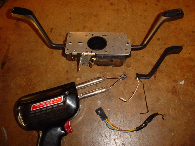

Okay, I did the cruise/obc install this weekend and it all went pretty well. I hope to do a more detailed write up but while it is fresh in my mind I thought I'd mention a few things people might want to consider in anticipation of doing this hack, no rocket science here, just some notes on things that held me up a little.
  1. When removing the airbag (after disconnecting the battery of course) you need a T30 torx, the trick is getting to it though. It's easier with the cluster out but even then space is limited. Some screwdriver style torx drivers may be too long, take a look at where the screws are and plan appropriately. I ended up with a combination of bits as my torx bits are part of a socket set and "holder" would not reach in to the hole where the screw is.
  2. To get behind the fuse box remove the cover then take out four screws, this will release the carpet panel covering the fuse box area. The fuse box is clipped to a plastic mounting bracket but it's a pain to unclip it, haf way down the side nearest to the door there is a screw, remove it and the whole assembly will come off, you can then easily take the panel off the bracket.
  3. The wiring in the wheel - it isn't complicated but take note of where it is so you know how to put it back.
  4. The top and bottom of the column covers take some wiggling to get back in to place, it isn't hard, just fiddly. Remember they attach to the outside of the stalk "box", they don't go behind it.
  5. You'll need a 24mm socket to remove the steering wheel nut, 15/16" will work at a push (thanks Charlie!). My socket sets didn't have anything this big so it's a shame to get held up half way through.
  6. When removing the cluster have some towels handy, as soon as you lift it up shove one underneath, there are sharp lugs under there that WILL mark you dash.
  7. You don't have to remove the hazard switch, once the three connectors are unhooked you can twist it round and out it on the passenger side of the dash. (on a towel)
  8. Don't drop screws under the drivers seat!!
  9. When inserting the connectors on the yellow wires into the harness there is a right way and a wrong way. Look at the harness connector, there is a slot that runs along it that will align with the "slot" in the wire connector.
Thanks to Richard, Charlie and Loren for their help as ever, if you guys have anything to add please do so!

I think you'll find that in an 03 it is much, much easier than what Ed had to do. When Ed first did this he had to wire it all up back to the DME, all of that wiring is in place in newer cars which makes life much easier, here's an abbreviated list of what I did with advice and guidance from Richard, Charlie and Loren:
1. Disconnect the -ive terminal and wait 5-10 minutes.
2. Remove the airbag
3. Mark and remove the steering wheel
4. Remove the steering column cover
5. Swap the stalk set over
6. Remove the cluster and run the new wiring to the cluster connectors
7. Run the 12v cable down to the fuse box
8. Reassemble everything
Then, assuming cruise has been enabled with the PSt2 you should be all set. The main instructions I followed were the original ones for swapping the stalk set over for OBC, they are good although some of the screw sizes are off in places. My notes earlier in this thread were intended to supplement those.
What I don't know are differences in a manual gearbox, you'll need someone else to chime in on that although I suspect the DME probably knows already as there is a clutch switch already in place for starting the car, I would think it would tell from that when the clutch was depressed (or the brake). Thinking as I type... that must be the case as my cruise turns off when I brake without doing any mods.
I think if you do the same as I did you'll be all set.
