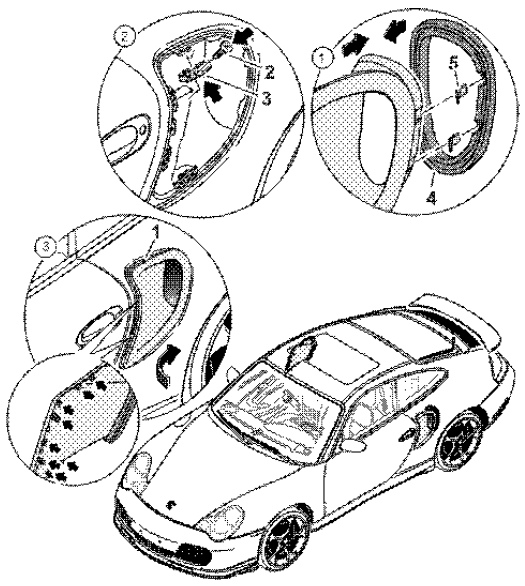

Turbo side vents fot intercooler
Removing
1. Remove air inlet.
Lift up air inlet 1 at the front edge evenly using an assembly wedge, disengage and pull forwards out of the air duct.
2. Remove retaining clips 3. Unscrew sheetmetal screws 2 and pull off retaining clips 3. If necessary, the tabs on the clips must be bent upwards using a screwdriver beforehand. The retaining clips must be replaced for installation.
3. Pull off seal 4. Pull off seal 4. Pull off spring clips 5.
Installing
1. Push on seal 4. Check seal 4 and spring clips 5 , replace if necessary. Attach spring clips 5 to the air inlet. Push seal 4 onto the air inlet.
2. Install retaining clips 3. Put new retaining clips 3 onto the tabs of the side section and align evenly in the lug bores. Screw in sheetmetal screws 2.
3. Install air inlet 1. Check lugs (arrows) on the air inlet 1 for damage, replace air inlet if necessary. Insert air inlet 1 in the air duct and engage evenly into the retaining clips.
4. Check air inlet system on the side section and check the gap dimension and make sure it is even. The air inlet system or the gap dimension can be corrected by undoing and shifting the spring clips.
Removing
Installing
