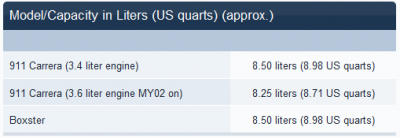

Model/Capacity in Liters (US quarts) (approx.)
911 Carrera (3.4 liter engine) - 8.50 liters (8.98 US quarts)
911 Carrera (3.6 liter engine MY02 on) - 8.25 liters (8.71 US quarts)
Boxster - 8.50 liters (8.98 US quarts)

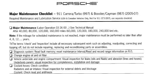

Great stuff! Thanks, but how often should one change engine oil and filter?
See the minor maintenance schedule for your model car.
Sorry, I guess I must be hit over the head with it, but I can't find any oil/filter change intervals in the downloaded Minor Maintenance schedule or my manual. What am I missing, besides a few brain cells? I can only guess that it's every 10,000 miles or yearly. Please forgive me for being such a pain.
Um... 2nd item on maintenance list...
It CAN'T mean every 40,000 miles. . . . can it? (I'm starting to feel really stupid here) Or maybe the On-Board Computer's supposed to tell me? And yes, I'm using the specified Mobil 1 synthetic.
I personally would not go over 12,000 between oil changes (or 2 years).
Many, many thanks for your infinite patience. 10-12K miles makes more sense to me.
Edited by 123taxi
Max change interval IMHO is once per year or every 12,000 miles.
I change mine every 6 months regardless of mileage but that is just me.
I'm used to an oil/filter change on my old M-B diesel every 3000 mi, so this is all quite new to me. And this on top of 355 bhp: I'm loving it! (My apologies Loren, if I strayed from the thread. . . )
You have to look at both the minor maintenance schedule and the major maintenance schedule. They dovetail with each other in terms of time and mileage. Thus, the manufacturer's suggested oil change interval in this case is every 2 years or 20,000 miles. --Brian
Ah. Good catch Brian! Thanks! Don't know why Porsche doesn't say that outright in their manual. Sure woulda saved me a lot of embarrassing and tedious questions to patient Loren!
Rick

Loren, when I change my oil I always put 10 quarts. I was told by a Porsche tech that they always put 10. But after reading some posts here some people have been only puting 9 quarts. How many is the correct?
