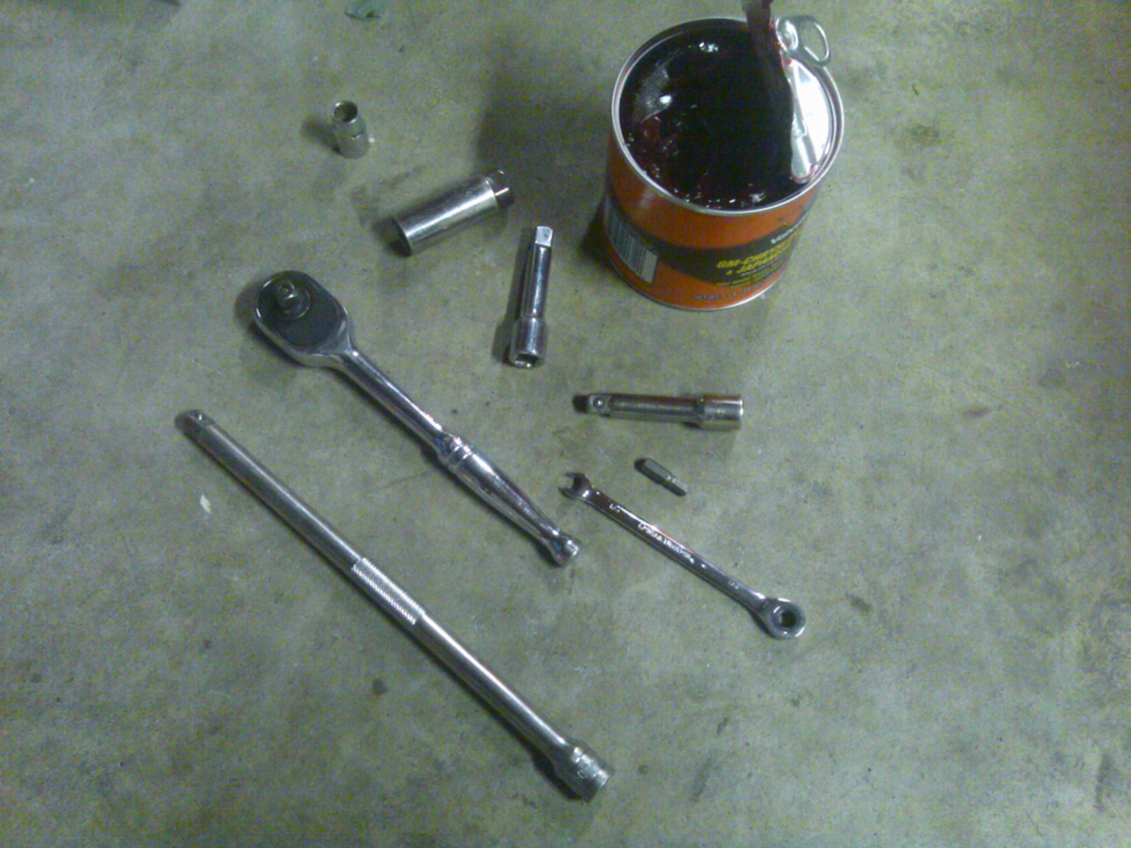

I just finished my spark 3rd spark plug job on this car. First try took me 6 hours, second try took me 4 hours, third try took me 2.5 hours so I wanted to share some tips on how to speed up the process (I did not have to remove the bumper or the exhaust)
ATTACHED IS THE PHOT OF THE TOOLS I USED:
- the wrench is used with conjunction of the 5mm bit, the closed end turns so it works like a rachet (this combination allows you to get into the tight spaces)
- the grease is for lubing up the spark plug so it wouldn't get stuck in your spark plug when you're taking it out
- the long extension is for reaching the 2 plugs on the left and right side of the car closest to the wheel
- the 2 mini extensions is for you to get to the other 4 hard to reach plugs, put the spark plug socket and the extension in first and then attach the 2nd extension and finally the rachet
- the 10 mm socket was used to remove the heat shield

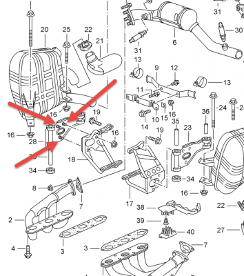

For those of you who have a hard time getting to cylinder 1 and 4 plugs! I followed Loren's instructions and was able to change my plugs. However, getting to plugs of cylinders 1 and 4 was pain #@??)*... but I got it. The second time I had to do this I removed the mufflers. This gave me a lot of room to work with and made the job a lot easier for me. Took me about 20 min to take both mufflers off the car. Just loosen the bracket on the cat side and the 3 13mm nuts holding the muffler to the engine support bracket (see pic). You don't really have to do this, but if you have big hands and a only small collection of extensions and universals this will help you a lot. Good luck. attachicon.gifmuffler.png
I can't wrap my head around how to remove the muffler. I will be doing my plugs and coils this weekend. (had the PO306 code thrown) hope it's just the coils and plugs.. #6 that i could see with the wheel off looked pretty rough, part of the plastic came off in my hand.
Is there a good muffler removal tutorial?
