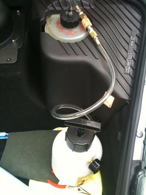

I do not know if anyone would be interested. But I purchased a motive european power bleeder from Pelican Parts and ended up not using it to bleed my brake lines. I hate to see it go to waste, so if anyone is interested in it, please PM me. Thanks!

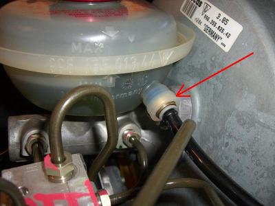

Question though: there is a small tube going from mid-reservoir into the cab (see attached). I was afraid of getting any air into this line (don't know what it's for, clutch?), so only pushed the fluid down to this point, not letting the level get lower than the tube. There was still a decent amount fluid left in the reservoir, so maybe it's best to suck it all out down past this tube using a syringe, thus allowing most of the fluid to be removed and for old fluid to stay in that tube instead of air getting forced into it. But, this pushing it out at least got rid of a bit of the old stuff first.

Can someone tell me what this is for, mentioned in a prior post?

That is the resevoir feed to the clutch master cylinder.

I'm not familiar with TT cars, so don't know their. The picts of the resevoir are of my '01 C4.
