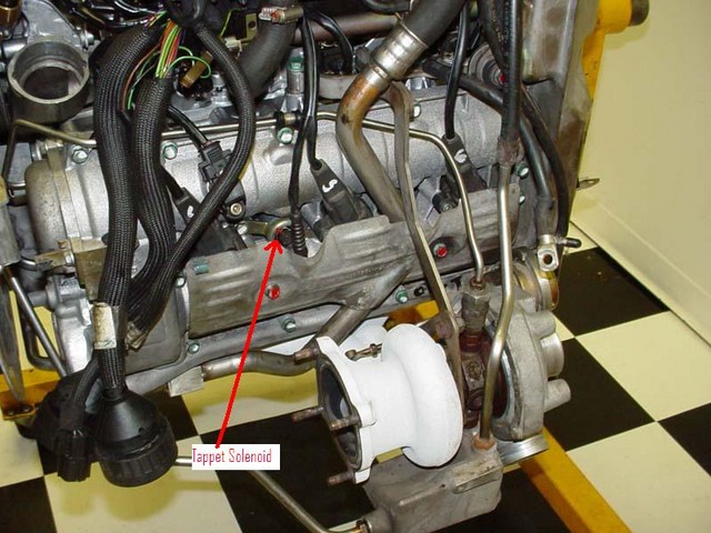

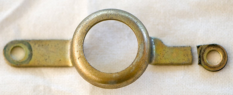

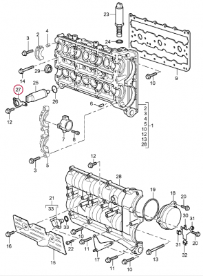

Another addition here when changing the spark plugs.
Check the condition of the cam solenoid brackets (1 per side) - item 27 in diagram below.
There have a few instances where these brackets crack or break and cause intermittent fault codes on the 3 cylinders on the cracked side.
Thanks to the folks on Rennlist that found this one.

Loren,
do you have to take off the valve cover to get to that piece?
Loren,
No, just the heat shield.
(photo courtesy John D II on Rennlist)
