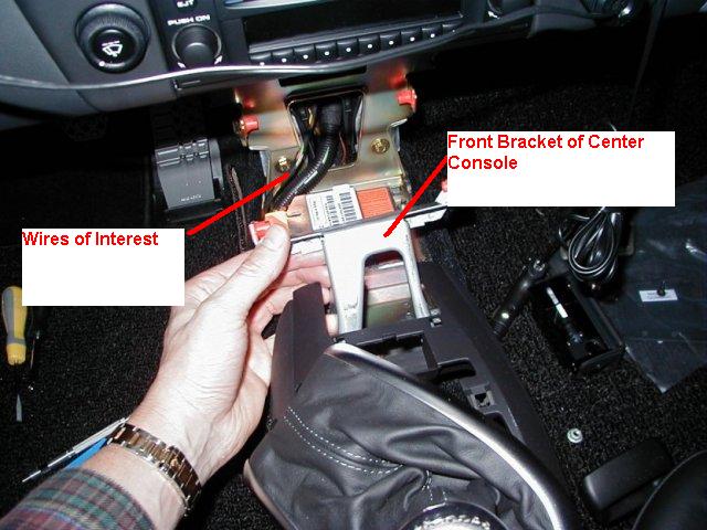

Thanks to Rockitman for posting his instructions with pictures.
I have nearly completed my console delete modification on my 98 Boxster. However, while removing the front mounting bracket in the attached picture, the thin bundle of wires (also indicated in one of Rockitman's pictures attached here) came loose.
Does anyone know what purpose those wires might serve? I can't see anywhere where they might connect. And if they're for some option I don't have, I'm concerned about rattles as those wires and the plug they join at is just flopping around loose under my console delete kit. Where is this small bundle of wires supposed to go? Please help, I'm almost done with this mod!

My logic tells me they are for any accessory bottons in the console itself - just under the cubby hole. Obviously you no longer have any of this now - so just tuck them away, cable tie them to something if you can to stop any potential rattles later on ...
Richard.

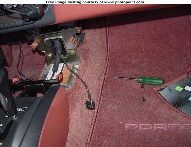

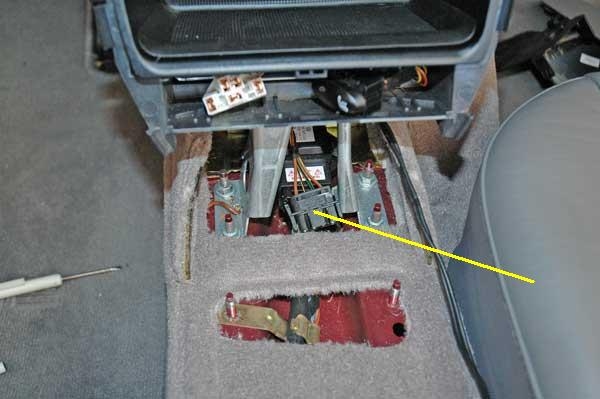

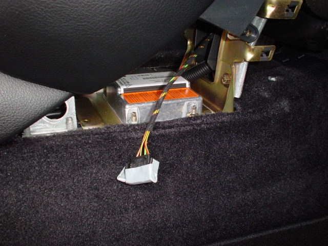

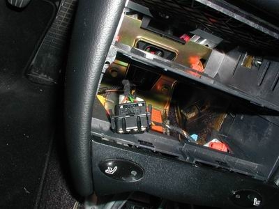

Need to see a picture of the connector. Most people find the unused cell phone connector and wonder what it is. It is black with 4 wires. And has no place to plug into. It is not alway in the exact location in the picture.
I think the 996 batwing has switches on it. Windows or heated seats - I forget. Those connectors looks different and has 5 wires.

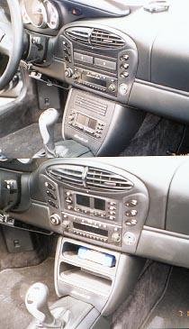

My center console has my heater/ac controls and cd drawers in it. Above on dash console is my radio and cup holders (which I never use). How difficult is it to remove cup holders and remount heater/ac into the void left by it before doing a console delete
You will need to remove the radio to move the AC controls/cables/wires up to the cupholder position. To remove the radio you will need the removal keys (don't buy them on eBay they charge $10 or more for the keys that are $1.98 from Becker). Tool Pants did a cupholder removal post here also. With the right tools less than an hour to move things around.
The cupholders you have, I call them the pop-out style, were only use for 1 year on the 996. They are easy to remove and move the A/C up above the radio where it should be. The only parts you need to buy is the A/C trim and 2 mounting brackets. Search on cupholderectomy.
The cupholders you have, I call them the pop-out style, were only use for 1 year on the 996. They are easy to remove and move the A/C up above the radio where it should be. The only part you need to buy is the A/C trim. Search on cupholderectomy.
