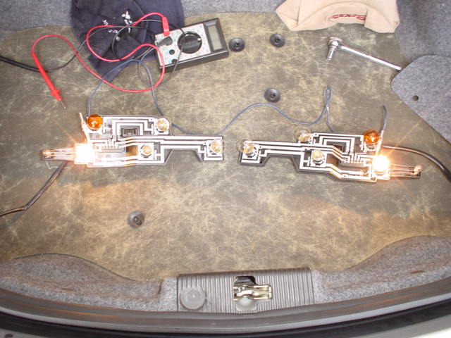

The right rear fog light in my Canadian 2001 Boxster S does not work.
I considered running a wire from the left fog light to the right. When I took the assembly out to do that I was unable to decide where to attach the wire to. Looking at the metal strip in the assembly, it appears that the daytime running light(the bulb to the far right in the assembly) positive metal strip is also attached to the positive side of the fog light.

I wired up the right side rear fog lamp on my 996, I took the power from the left lamp on the harness behind the rear light assembly connector, ran a wire over to the right wring harness connector. If you do it this way, then you can unplug the lamp assembly from the wiring harness and still remove it from the car.
Just remove the left lamp assembly and follow the wire from the rear fog lamp back to the connector.
It is done the same way on a Boxstir. You run a jumper wire from the fog light wire on the left bulb holder that has power to the wire on the right bulb holder that does not have power.

Hate to be a nerd, but where exactly is the jumper wire attached to? I tried it once by attaching it to the metal bit of the circuit on the fog light, but I blew the fuse :-(
I assume you soldered it on?
Is there any specific guage of wire needed?
