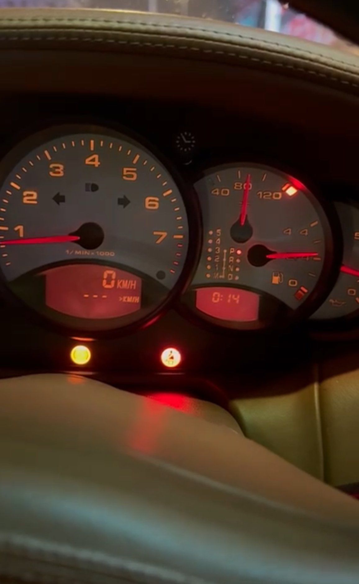

Hi, I have a 2000 carrera 4 cab, with 49k miles - my light blinks slowly ( even when cold) - coolant level fine.
thoughts?' I have anew resavoir cap on order - looking for a coolant sensor - struggling to locate a part number? Without taking the old one out
Share this post
