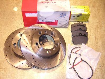

here you go TP
http://cgi.ebay.com/ebaymotors/ws/eBayISAP...AMEWA%3AIT&rd=1
It has been said Zimmermann makes the rotors used by Porsche. With Zimmermann you can get rotors with the holes for the base Boxster.
I thought you were looking at this type of kit I have seen on ebay that also has the pads and sensors. The kit in the picture is for the front on the base Boxster. We reuse the sensors unless the warning light is on.

I was thinking of this type of kit I have seen on ebay that also has the pads and sensors. The kit in the picture is for the front on the base Boxster. We reuse the sensors unless the warning light is on.
