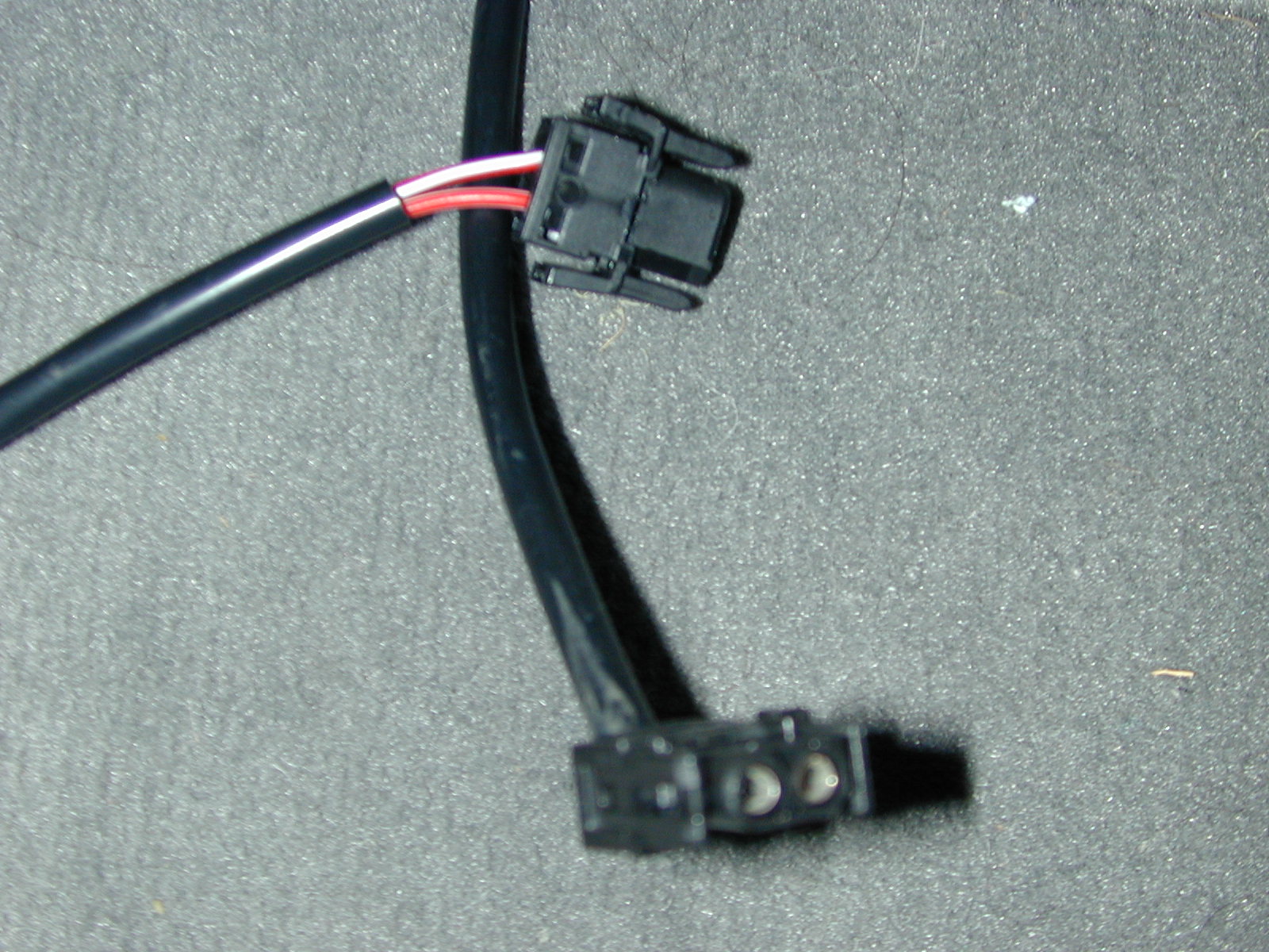

Hi Did you by chance confirm that the heating elements are not already in the seats?
I only ask this, as the option price to add heated seats, is so small, 310 UKP in the UK, that by Porsche prices I cant see that its economical for Porsche to carry 2 types thro manufactoring? I'm wondring if when OEM switches are added the rest might already be in there waiting!!
Look for some plugs under the seat? that are not being used
So... if those unused plugs are there, under the seat...do you think one could order the control module, relays and switches needed to retro fit the factory system? Or are you saying the switches/relays of an aftermarket system could could be used with those plugs?
