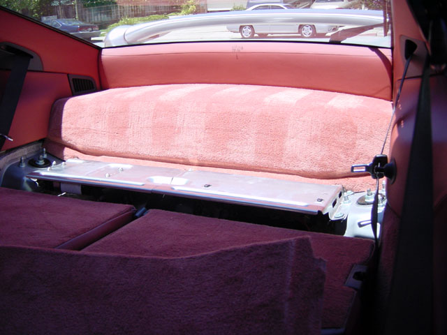

Do you have the TSB on how to remove the passenger side C-pillar and rear carpet in order to gain access onto the rear deck?
FYI... These items are not in TSBs (Technical Service Bulletins) they are in the service manual.
The C pillar unsnap by pulling forward (towards the car interior). The foam piece over the DME can be removed to get access to the rear deck.
