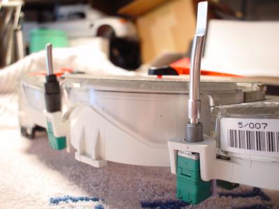

I do have some spare parts like the adjustment posts that seem to be bent in the pics above, but the lcd board I have is fried. The only other cluster I have is a later model 996 one that I bought by mistake when I did the cluster swap into my car. I need to throw it up on ebay or if anyone is thinking about swapping a 996 cluster into a later boxster let me know.

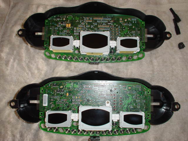

When I got the 996 cluster long ago I wanted it so bad that I took my Boxster cluster apart to see if I could swap parts over, and I saw that I could. But as I stated in the previous thread, I chickened out because I thought I would end up with 2 clusters that did not work properly.
My Boxster cluster is on top. The 996 ebay cluster on the bottom.

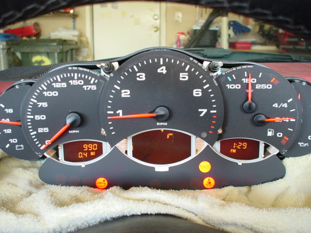

Here is my experience in swapping the 996 gauges onto the Boxster LCD board. It works just fine and allows you to keep the odometer mileage correct for your car. A couple of caveats.
1) I you use the 996 speedo gauge face to 175 mph, the analog speedo will not correspond to the actual speed. The output from the digital board must be different between the two to account for the different ranges and not the electrical gauge portion.
2) the voltmeter gauge portion did not work. This is how I fried my boxster lcd board on Friday, trying to figure out why. With the 996 lcd board hooked up to the 996 gauges it worked just fine, but swapping in the 986 board with the 996 gauges it failed to work.
This may or may not be universal but is something to keep in mind. Oh, and don't hook 12 V to the voltmeter gauge directly, the gauge will work fine when disconnected from the car but when everything is hooked up it will fry the cluster. Ask me how I know :)

When I put the 986 board in the 996 cluster I had the same issue - the voltmeter did not work. http://www.renntech.org/forums/index.php?showtopic=304&st=20
I did not drive the car with it this way to see if the digital and analog speed displays matched. There was no reason for further testing since the purpose was to have the voltmeter and oil pressure gauges.
As you said, the boards must be different.
Both shafts are bent/broken. The middle LCD display has missing segments. Other than that it is in great shape. :lol:

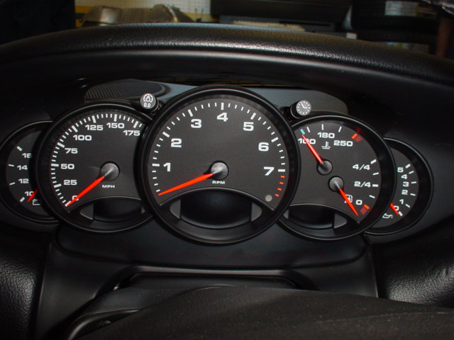

Finally did the swap: very easy and a positive surprise, the outside temperature was working as well (no need to visit the Porsche dealer).
The cluster I bought was from a tiptronic (mine is manual), so I have the 4th geat flashing continuously. But everything else works fine.
I simply cut off some plastic in my original trim going around the cluster to fit the two additional gauges.

Here is a photo of an '02 996 Turbo cluster installed in an '01S Boxster. I added the 996 oil pressure sender and wired it up to the cluster. All gauges work including the 200 mph speedometer (which is just as accurate as the original 175 mph one), with the improved readout of the 02 OBC display. The only issue is that the oil level readings do not work due to the different functionality of the Turbo engine's oil reading - that is why the non-turbo gauge is preferred. I was originally just going to switch the two extra guages over to my Boxster cluster, but decided to stay with the new setup for the time being. Generaly, the Turbo gauges are cheaper on Fleabay because of this compatibility issue.
