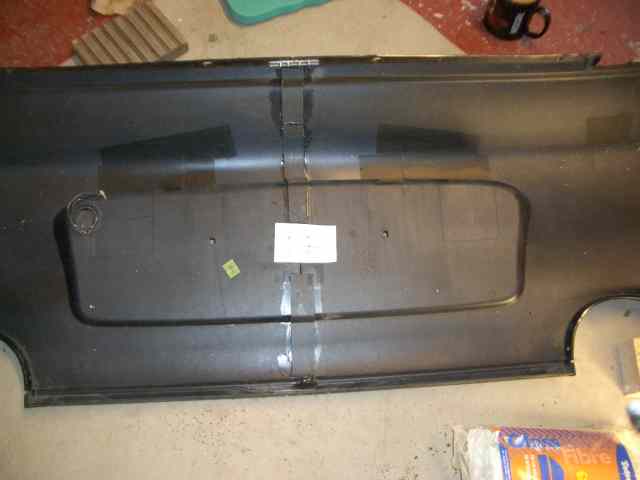

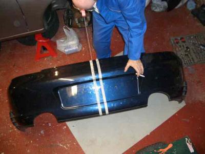

I am going to fit a turbo rear bumper fender etc to my 2001 carrera 2 coupe. Seen this done on here a few times & they don,t look bad, however i am thinking of cutting it in half & removing 1" in the centre & bonding it back together. Any feedback would be appreciated .

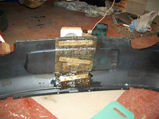

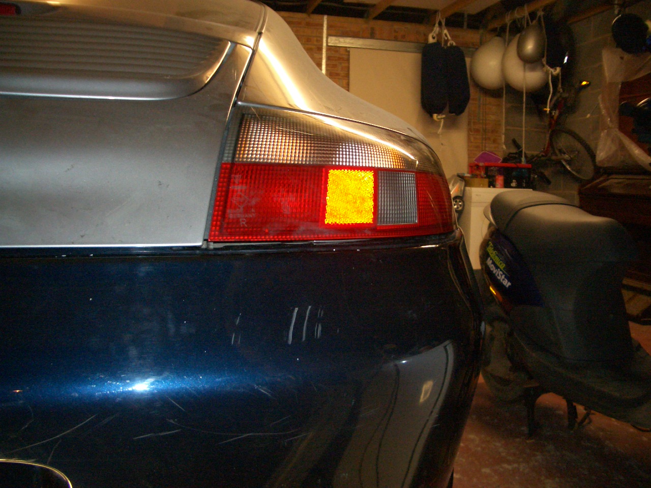

Got the bumper on. Just needs centre line filling & painting now. Fits very well.
Oh, looks good.
Please keep us posted as I might do the same.

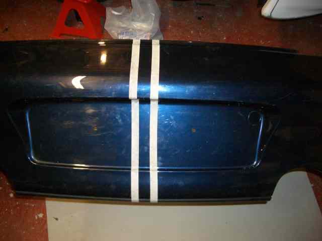

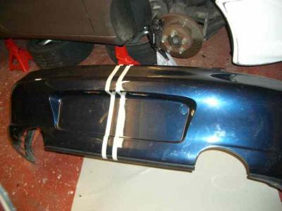

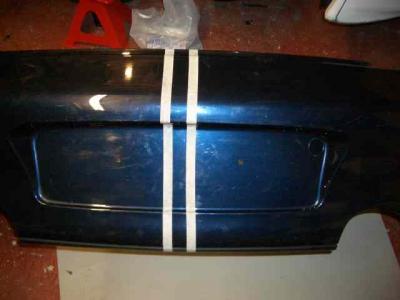

Do you have any pictures of the cuts, and where?
I have a turbo rear bumper in my garage, I mind as well make use of it.
Thanks. :D
Yes see attached photos, Will put as many as i can on, Plenty more as i am doing a full workover an the car , All need to be painted but front is done with MASHAW turbo look bumper, Rear is just about done, MASHAW clubsport rear lid /spoiler is on & fits well, Just got gt3 side skirts aftermarket ones & there gonna be a sunbitch to fit so not sure on them yet, May have to splash out on some oem ones yet, Carrera wheels & bigest spacers i can fit + lowering springs, Oh & forgot silencers are off ready for bypass pipes welding in with some 1\2" stainless tube. Also air filter to play around with. Hope with about six weeks to post a finished car on here, Cheers Steve UK.
Yes see attached photos, Will put as many as i can on, Plenty more as i am doing a full workover an the car , All need to be painted but front is done with MASHAW turbo look bumper, Rear is just about done, MASHAW clubsport rear lid /spoiler is on & fits well, Just got gt3 side skirts aftermarket ones & there gonna be a sunbitch to fit so not sure on them yet, May have to splash out on some oem ones yet, Carrera wheels & bigest spacers i can fit + lowering springs, Oh & forgot silencers are off ready for bypass pipes welding in with some 1\2" stainless tube. Also air filter to play around with. Hope with about six weeks to post a finished car on here, . Front fits well now but MASHAW instructions were not good. Cheers Steve UK
Forgot to say to use the piece cut out. Cut into managable pieces & use plastic guttering solvent glue as this actually welds the surfaces together as opossed to just gluing the pieces together, Don,t sniff the stuff though it,s pretty strong, Ha ha unless you make a boo boo then its last resort, Take care , :eek:
Hi there stan. The exact amount is the strip you can see in the photo,s. It is 30mm I.E 15mm each side of the centre line. Will be getting the lot painted soon , Just finishing off the side skirts then all off to paint shop. Thats a none oem front bumper. Genuine rear TT bumper, Side skirts none oem, & lastly the huge MASHAW rear wing come lid. I must say i am a bit of a cheapskate as the whole thing has not cost very much. £80 rear bumper e-bay. £200 front bumper porscheclubgb member, £300 rear lid porscheclubgb member & £165 side skirts e-bay. Oh & a pair of used silencers to modify £19 e-bay. Not sure how much painting will be though, probably quite a lot. \cheers. Steve UK

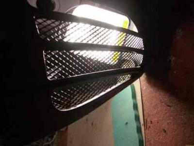

Hi no not done a great deal for a couple of weeks. I have bought some genuine GT3 side skirts instead of the glass bibre ones i had but they are not any better in quality just that they are plastic so may be more flexible from kicks etc. The rear bumper needs four spacers placed under the edge where it sits along the trunk lid, about 3/8" as the turbo mumper is raised just there whereas the standard bumper is not. It could be some time before i actually finish the job , With work comittment & i am prepping my boat to sell. Cheers.. :D

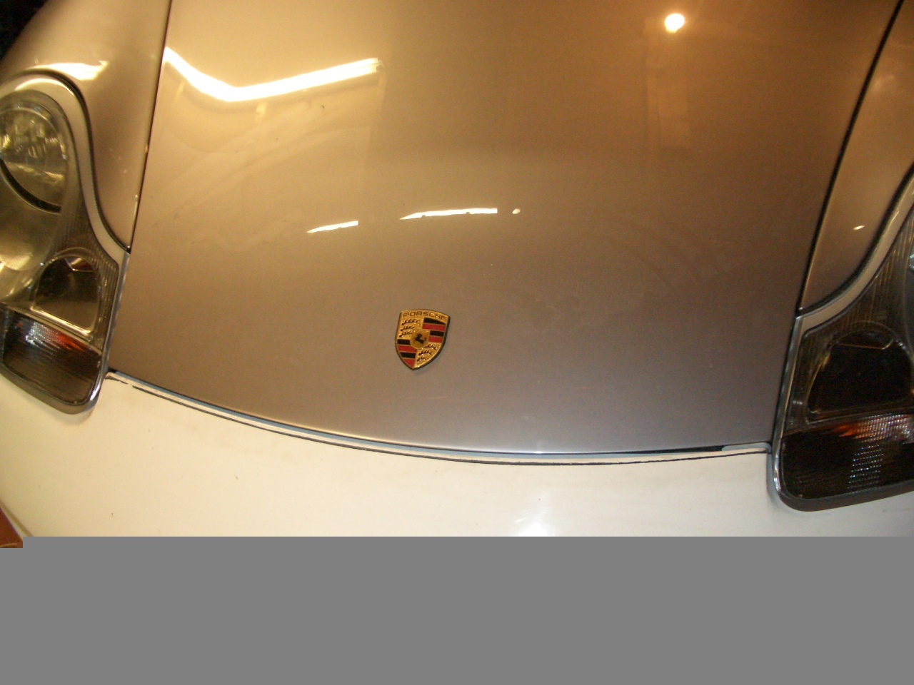

Hi all , well the whole project grew, started as front & rear bumper conversion to turbo look. Now after this evening picking up the Gambella rear lid, i have all in place for a soon to be completed monstrosity , which is. Deep breath. Gambella rear lid spoiler, Modified turbo rear bumper, turbo front bumper, Gt3 side skirts, Zenon headlights, Lowered 30mm H&R springs, Wheel spacers, Carrera wheels, My own modified exhaust boxes with 1" by-pass pipes,(loud as hell) & other bits. Soon to be completed, I will post pics & sound clips if possible when done. Is there any other idiots out there that takes a perfectly good car to pieces just for the hell of it. Keep this thread alive. Regards Steve UK. P.S still messing with induction, No gain just a sh-t load more noise. Cheers...

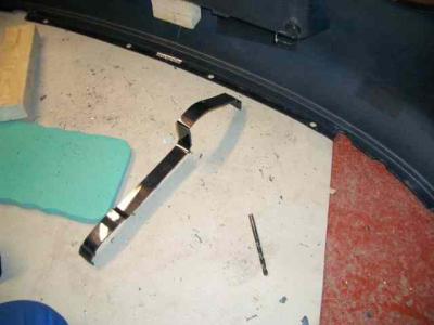

The exhaust mod was a result of basicaly copying the PSE but without the valves so on all time. I looked at the PSE ones & the link pipe is about 15mm dia. I made up the same pipes in stainless but used 25mm bore pipe. The sound is about 30% louder than the PSE with a real crack as you rev it. Are you narrowing a turbo rear bumper or buying one done. The rear job requires the purchase of the carrera 4s tail pipe bends & turbo tails but the tails need a shim wrapping round as the turbo tails are loose. Keep in touch. Just finished putting the 1st lowering spring on rear tonight. Try & do another over the weekend & fronts next week. Cheers..
Yes, doing a narrowing, much in the same way as yours. I am aware of the problem with the tips, but I was thinking about cutting new exits for the existing ones and blank out with fibreglass where necessary
