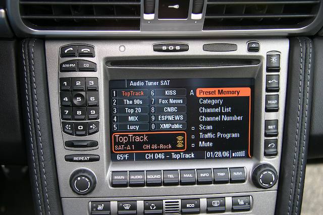

There is a thread on Rennlist about installing the Cayenne Sat tuner in a 997 by an audio shop, and the photo seems to show that it worked.
My question is this:
Would not the audio shop need to have a PIWIS tester to "Code" the sat tuner to the PCM?
You just can't add the module and it will be recognized or can you?

According to the Cayenne install TSB some Cayenne's may not need to be coded. It may also depend on what other options are already on the car.
I will let you know shortly. :D I have the Sirius parts on order now for my 2006 997S!!!! :king:

Loren, the TSB has definitive PIWIS instructions. This leads me to believe it is required. I guess the question is...if the MOST Actual and MOST Required parameters match up exactly when you look it up on PIWIS, i.e., without needing to actually change any settings in PIWIS and instead just read the screen, it begs the question as to whether you needed to hook up PIWIS at all. In that case, would it be 'plug and play' without needing PIWIS? I will soon have an answer for this question. Do you have any info that would shed light?
Point of reference...adding the CD changer has similar steps in that the TSB for the CD changer has steps for PIWIS hook-up. But maybe the latest PCM2.1B changes whether PIWIS is required if the parameters already match up, unless this has always been the case.

Some functions can be preset using a PIWIS and some can not. Sometimes cars come with some options preset and sometimes not.
IMHO... the main reason for hooking up a PIWIS (or PST2) after an install is to see if there are any trouble codes generated by the install.
You won't really know if it is "required" until you try.
